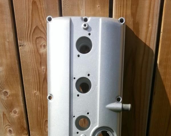

Last summer I couldn't stand seeing my cam cover in it's sorry state as that was the
only thing holding me back from popping the hood to those who were curious
so I finally took it all apart and had the cam cover, bolts, and supercharger
duct work silica blasted then powder coated metallic silver. I also
went ahead and had the fuel rail and coil cover painted body colour;
Ice Blue. 8 months later it looks the same - on the outside anyway.
I had some oil in 3 spark plug wells. I replaced the coil
gaskets dry but I used the sealant pictured below for the cam cover
gasket tightened to proper torque with no leak issues.

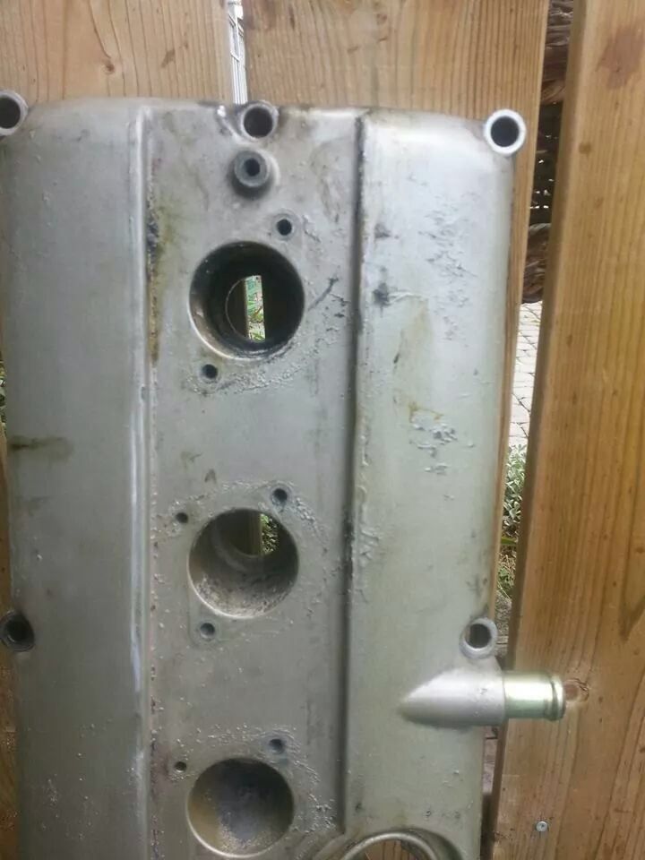

When you say you applied the RTV to "the plug tube seals", do you mean the RTV was applied on the face of the seal so that it would be between the head and the seal (as shown in the area of the red arrows in the photo below)? (Disregard the red circle in the photo showing the corrosion/separation on the old/bad cover).
