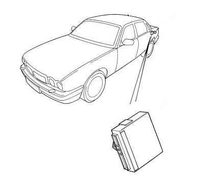

Is there any possibility something operating on the same or a close frequency nearby is interfering with the fob signal when this happens?
From your description, it doesn't sound like the fobs are at fault as you don't have to do anything to them other than drive and wait. Have you checked the connections to the Security & Locking Module?
If there are no harness / connection faults, reprogramming the fobs may help. I never had issues with my X300 fobs but have had an X308 that would lose the fob to security module pairing occasionally and reprogramming the fobs fixed that.
