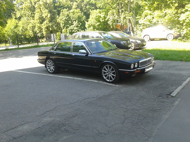

Just my small personal experience:
I have fitted the 19 inch Atlas rims (factory wheels for the X100 XK series, 8 inch wide with 245/40 tires on front and 9 inch wide with 255/40 tires on rear) to my Daimler X305, they were a direct fit, zero problem. The suspension behavior is supreme to my liking, I prefer it much more than with my previous 16 inch Turbine wheels. Needless to say that the car looks great too.
Attached Thumbnails Fitting 18x8.5 milans to x300 help please.-20150706_095250.jpg
