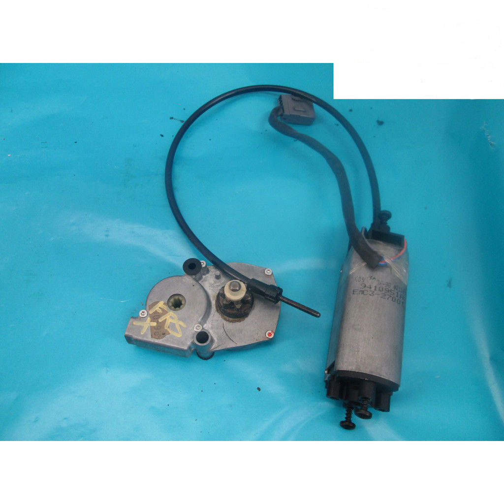

The front rise fall on my X308 stopped working and I found (like everybody else) the cable out of the gearbox socket. What first puzzled me was to see the inner cable protruding out too much. I thought it must have disengaged from the motor side but I could not push it in any further and verified that it was properly engaged into the motor (pulled the cable out completely, reinserted it and could feel when the square went into the motor socket). Ran the motor and the cable was turning fine. When I measured the depth of engagement into the gearbox, I found that the inner cable was protruding out of the sleeve (in relation to the connector) 8 mm more than what the gearbox socket can accept and relised that the plastic tube has actually shrunk over the years and pulled itself out of the gearbox socket. As shortening the cable is not really possible (due to specially shaped ends of the squares), I decided to lengthen the tube. I had a bad short cable (brand new but with a crumbled tube) so I detached one end-clip. Cut-off the end-clip on the shrunk cable as shown on the pic and connected the new end-clip with an aluminium tube, glued with epoxy. Works perfectly.
Another way is to just cut the tube anywhere and lengthen it with a metal sleeve but I did it the way I described because I already had a new end-clip. The maximum that the inner cable can protrude out is 14 mm.

Bought a couple of these for spare. The inner cable is sticking out quite a bit so the sleeve obviously needs to be extended. It looks like the plastic tube on all suffers the same problem - shrinkage. On my seat, the tube has not only shrunk lengthwise but also in its cross section. It took quite a bit of force to pull the inner cable out and push it back in. However, when fully seated into the motor socket, the cable could turn fairly freely. The hard pulling out / pushing in was caused by the square portion of the cable, which is slightly bigger in diameter (diagonally) than the round portion, passing through the tube. The tube cross sectional shrinkage was such that the square portion of the inner cable could not pass through it freely anymore.
