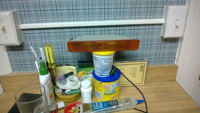

It had a hole in it from a rock or something. I took it off and found about 95% of the broken parts still inside the light. So I glued them back in place and sanded every thing so it was smooth and polished the light cover.
I think I could spray all the turn signals with some smoked lens paint and you would never know it was broken.
Sorry for no before pic the hole was 1in x .5in in size. Please excuse the old wallpaper in my garage.

It was a lot cheaper then buying a used one. The only other thing I might do is get some clear epoxy to fill in one spot. Then spray it with this stuff O'Reillys sells called nightshade.

I was going to buy a used one but when I was washing the car I saw most of the broken parts were still inside the light so I figured I would give it a try. I think if i used this stuff it would look near perfect.
