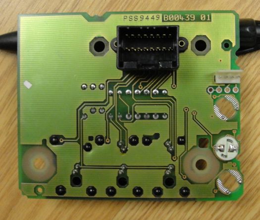

Has anyone attempted or successfully repaired the lenses or "jewels" in the front and rear foglight switches?
What tends to happen, and did in both cases for my front and rear foglight switches, is that the little plastic frosted lens on the switch indicator light breaks free and falls into the switch.
This causes a couple issues, rattling to a small degree, and a less than ideal lighting of the indicator when the switch is engaged.
In my case I can hear the little lens rattling inside the switch, so they are in there.
What I'm wondering is if these switches can be opened, the lens re-glued, and the switch put back together reliably?
I see quite a few of these switch panels for sale used, but I hate to buy a whole panel when mine is known to be good, and of course the used panel is not free And a used panel may have its lenses pop out soon after too.
I have attached a few photos of the switches I am talking about, and you can see examples of the lenses in place, and when they've fallen inside. You can also see the rear of the switch panel, which doesn't look like it allows easy removal of the switches themselves.

All fixed!
Finally got around to this now that the weather is nice again, and I was already in the dash doing a couple other things.
Sorry, I didn't take any step by step photos. But once the switch board is out of the dash, the rocker switch covers pop right off with a gentle pry from a flat screwdriver, and it is pretty obvious what one has to do.
One will find the "jewel" lenses running around free inside the switch housing. The lenses have a small flange around them that holds them in place in their hole, and a few drops of glue will re-secure them to the inside of the switch rocker.
Once glued back on, just snap the rocker switch back on, and you're in business.
