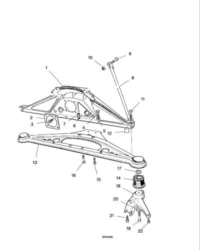

I've attached a photo of the part I am talking about, which is item #13 in the diagram.
