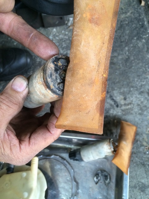

My mechanic has finally managed to remove the fuel tank from the car to enable a good wash and proper replacement of the twin pumps. He said although he had previously emptied the tank of all fluid, there was nothing but a thick layer of yellowish mud at the bottom of the tank. This was probably because Rose had stood in the open for nearly three years, so rain, dust and contaminants of all kinds had found ways to enter the fuel tank and mixed with fuel tank deposits to become mud.

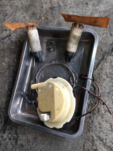

The original twin pumps were still working, but might fail any time. See the deposits on the pumps and the filter attached. So although it is a great pain to remove the tank, it being a 20-year old, the fuel tank and pumps would have to be attended to at some point if the car is to pursue a new life.

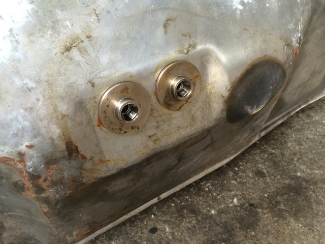

The bottom fuel outlet holes were also cleaned up.
