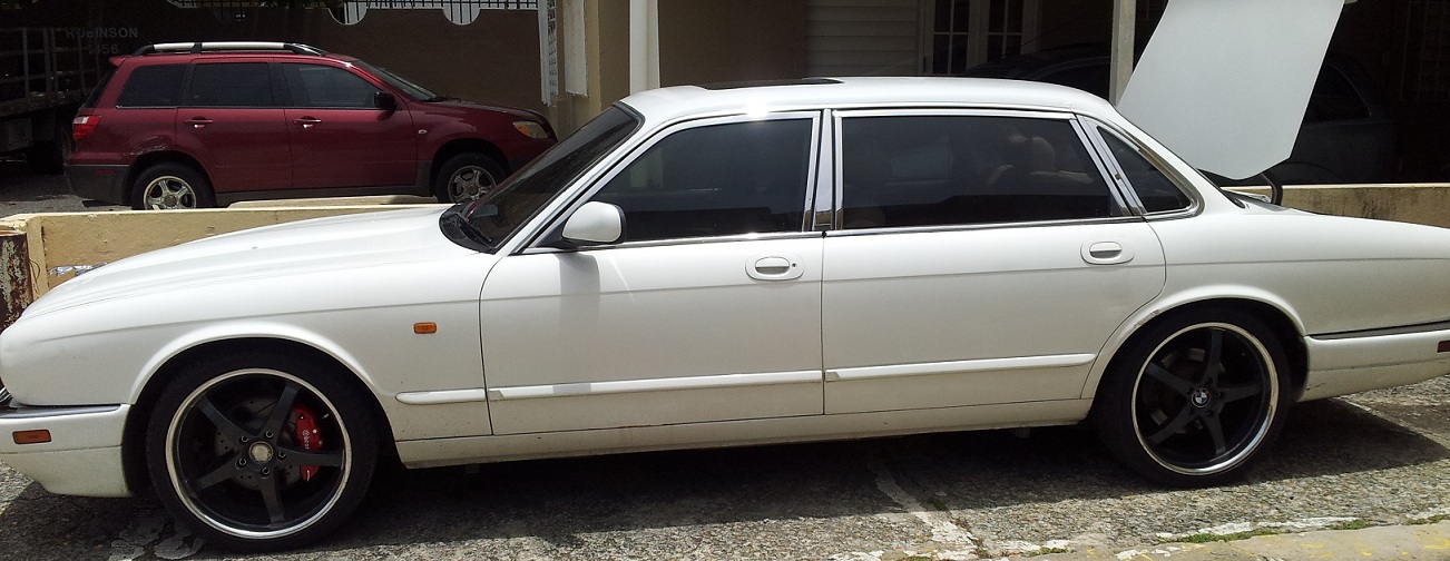

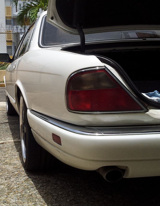

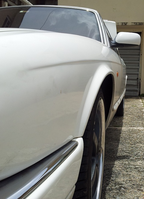

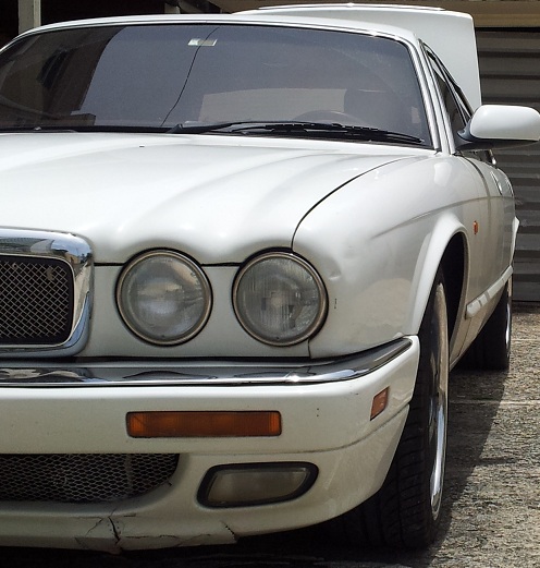

took some pics to show what I mean about the wheels being 1.5" inside. im also getting tramlining.

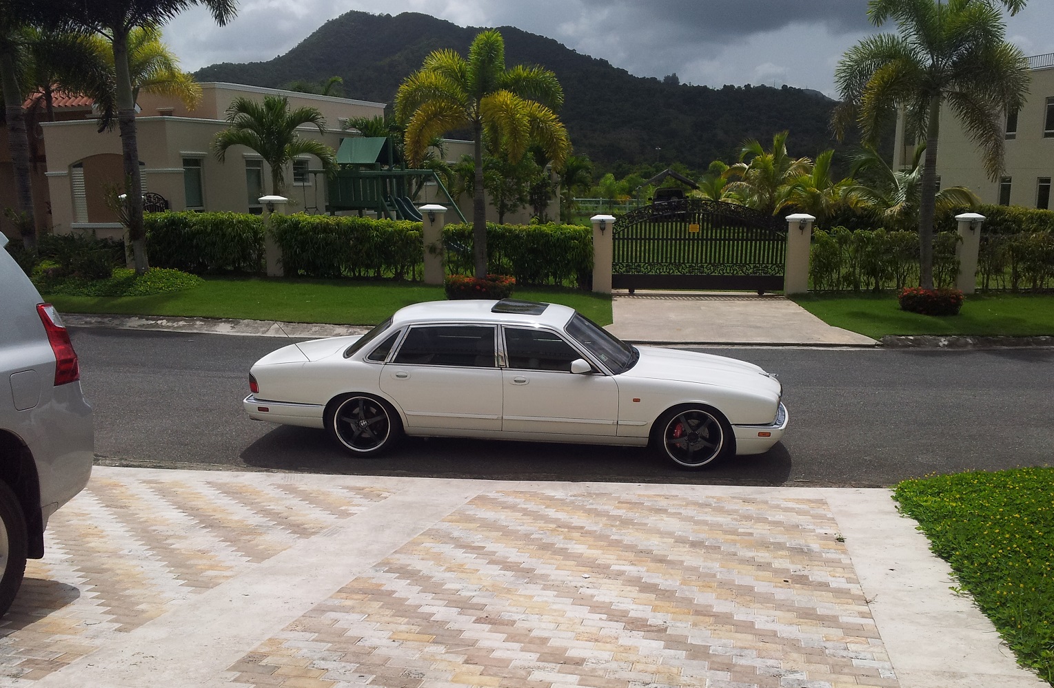

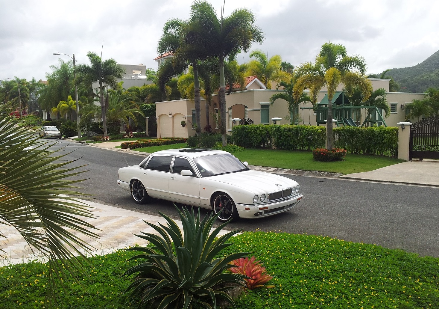

a little update with car cleaned, still no spacers.
