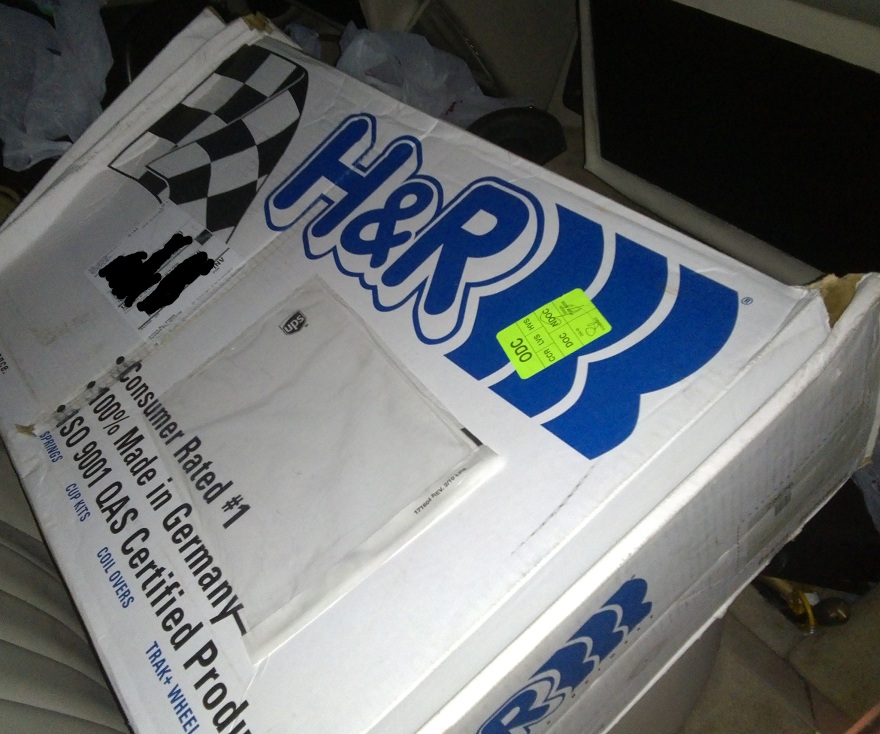

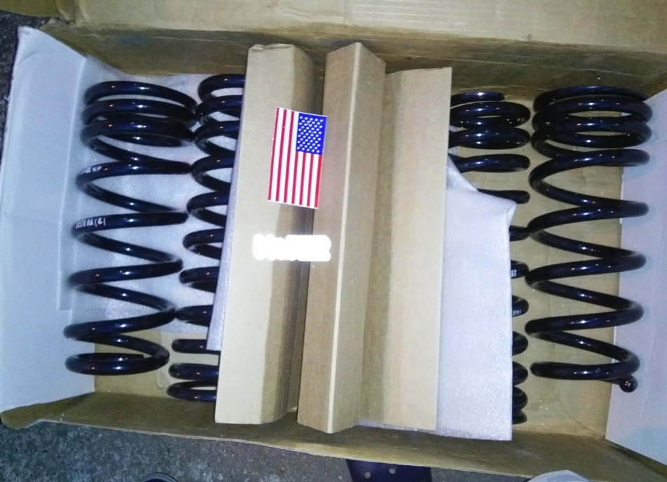

and springs finally arrived. now need to find a nice walkthrough on installing this without mayor setbacks. im guessing its possible to install them using a regular jack stand?
