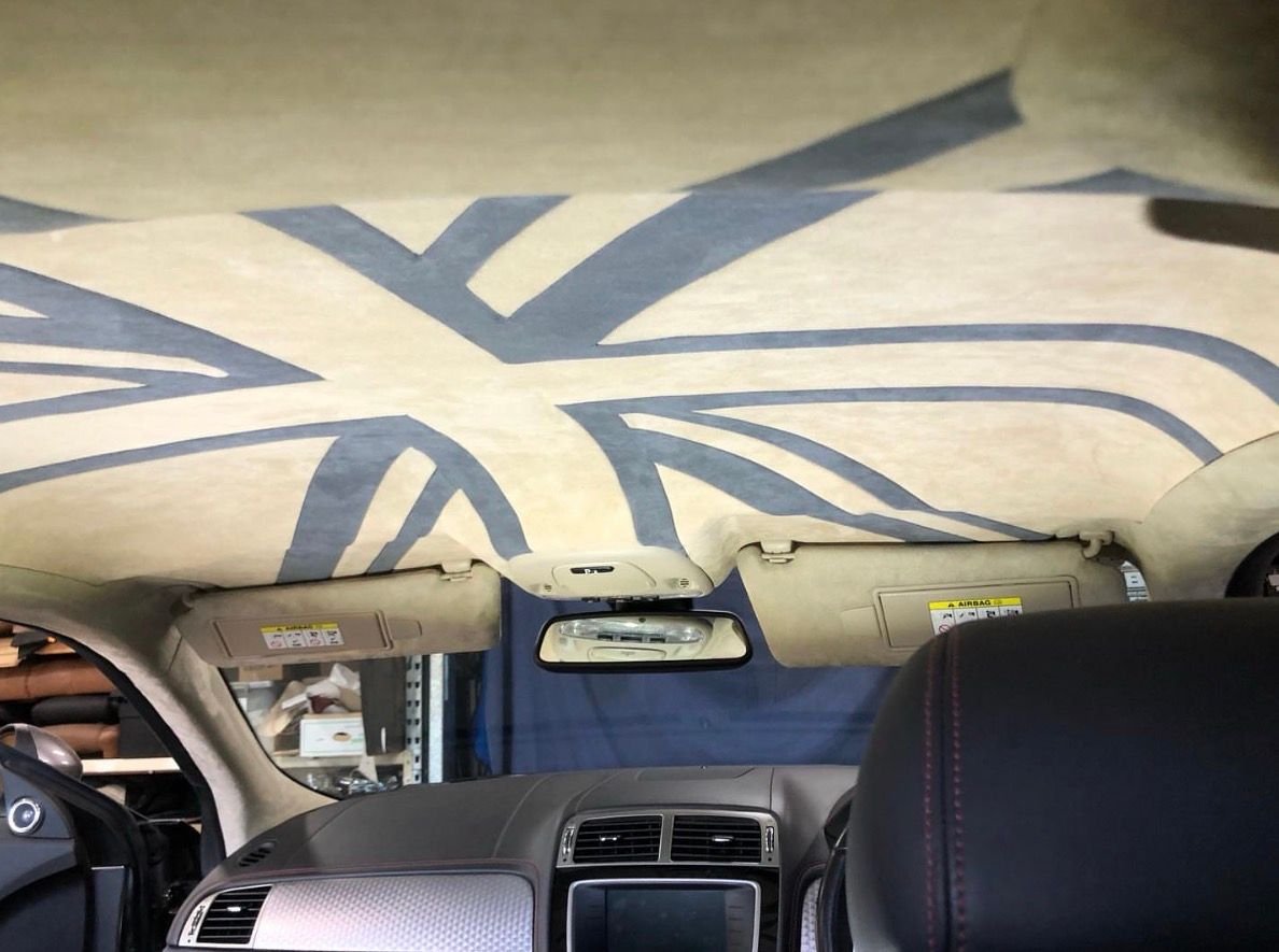

Old Nov 9, 2025 | 11:42 PM
Robjo's Avatar
Joined: Nov 2025
Posts: 2
From: Australia
Smile
When mine sagged we took the opportunity to have a bit of fun…
