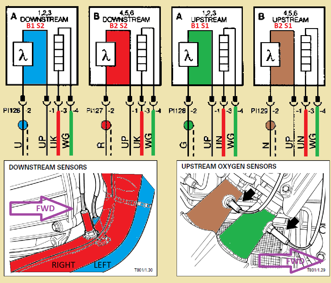

As a cold engine and the fuel ratio set ( my assuming )
Your closed loop tripping point is 88 C
The O2 sensors will not be used at this time but as Vee mentioned is tested
Engine CEL codes , they can be read and cancelled by a ELM - 327 device otherwise a auto parts store can read , write them down as memory can be fleeting
Vacuum leaks ?
The MAF will read 1.2 volts DC ( at proper idle ) on the middle wire , still connected so you can stab the connector as the wires come out , about 4 grams / second at proper idle ) on a ELM - 327 but can be errored by a factor of 10 or 100 ( device software issue ) whatever numbers make sense
The valve cover is not a valid ground point for your meter
The rear most coil wires swapped ?
# 6 Light Green / Purple , rearmost
# 5 Light Green / Orange
The rear O2 sensor connectors can also be swapped , swap back up top
So on the car side of the connector it has 4 wires , 3 being the same and the 4th return signal wire is different color
