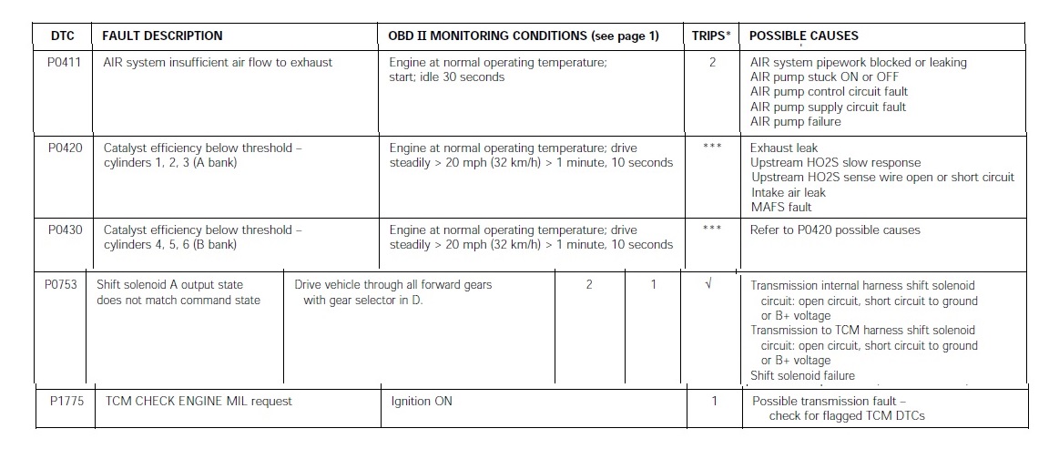

Here's the extact from the Jaguar DTC Listing for the codes you have recorded. The Possible Causes for each are shown in the right hand column:
Not the neatest extract I've ever put together but it should give you the information to start troubleshooting the causes.

The diagnostic chart already provided gives the most likely causes. However, some X300 owners have never been able to identify a fault that would explain why these two codes pop up. There's some speculation that the fault is an anomaly within the OBD system itself.
