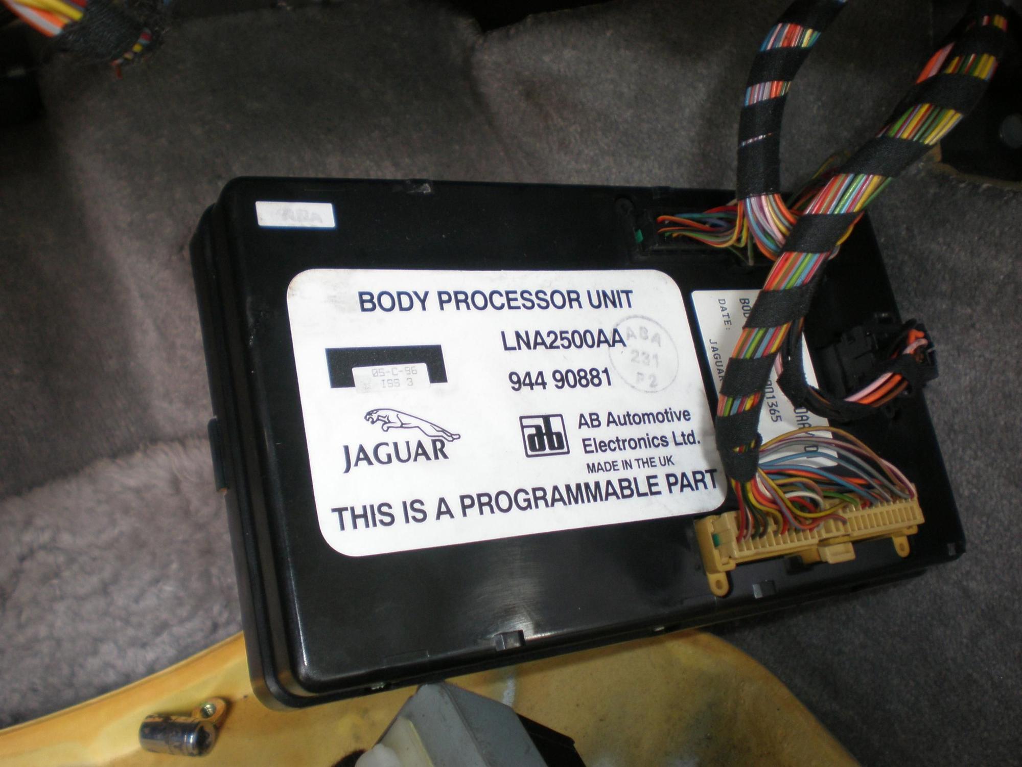

In removing glove box to get to BCM keep careful track of different size / location of panel hardware and the elongated holes position as a pain to get final panel adjustment
The BCM has a large christmas tree insert that holds in place to remove

thank you for the awesome picture! and the great tips. today we finally decided to call the local jaguar dealer (they are highly rated) and they will be sending a mobile unit to our location to try and reset the remote key fob and locking systems. not sure why we did not think of this sooner. maybe the remote just needs to be re-synced to the security system by the dealer? i will keep everyone posted.
