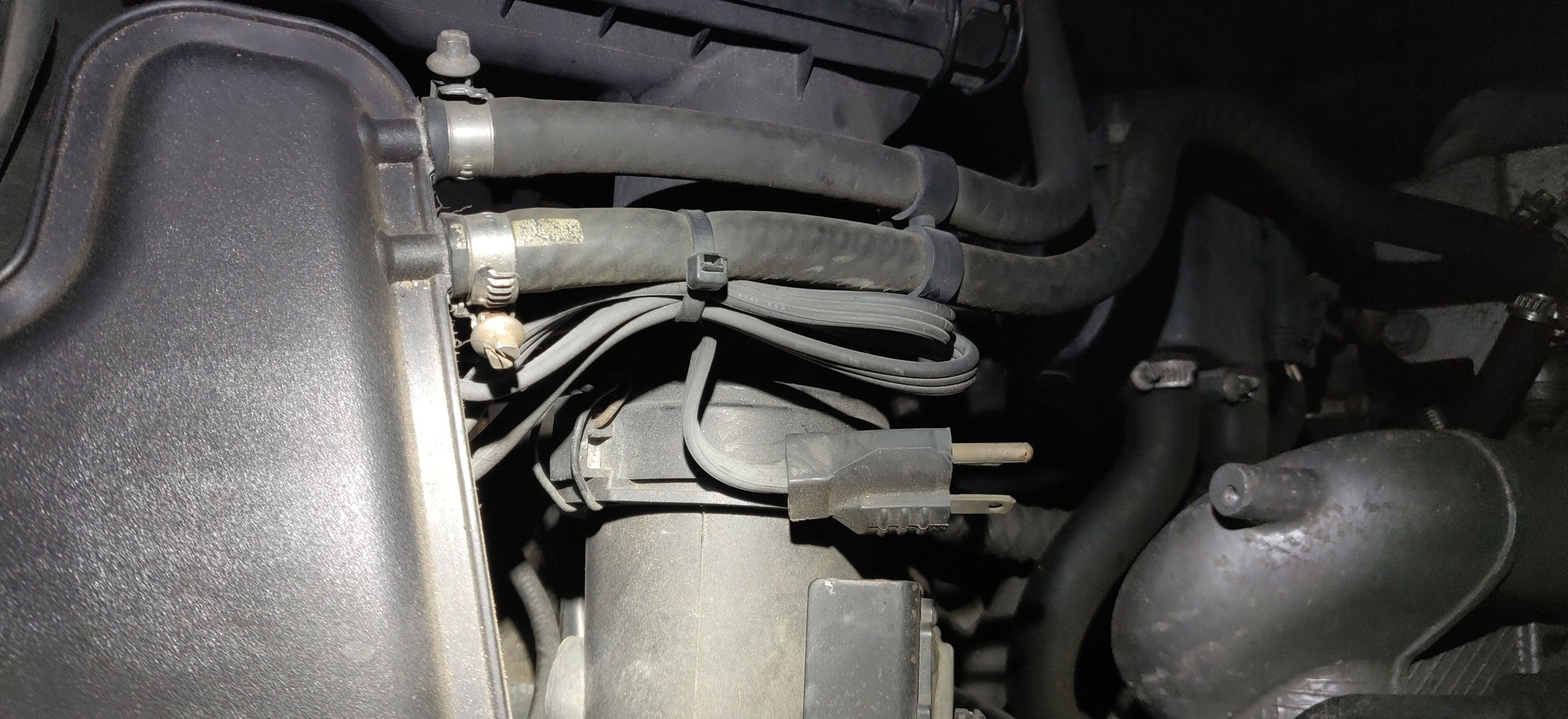

What's this plug for it's zip tied on the coolant lines coming from the reseviour and is attached to the red clip on my main hose. Can someone tell me what it does please?

That is a block heater. Used in cold climates to preheat the coolant and the oil, it does a few things. It makes the engine easier to turn over, so there is less draw on the battery, and by warming the oil it allows it to flow into the engine faster, which means less wear on the engine.
A battery at -20 has only about 10% of the capacity that the same battery will have at room temperature, so preheating the engine to make the oil less thick can sometimes make the difference between starting or not starting. In very cold weather ( say -40) you often only have one chance to start the car before the battery is completely drained. Every advantage is needed to tip the balance in favour of starting. It's disheartening when you turn the key and the starter does a whirrr - and then nothing as it slows to a stop after maybe 1/4 revolution of the engine.

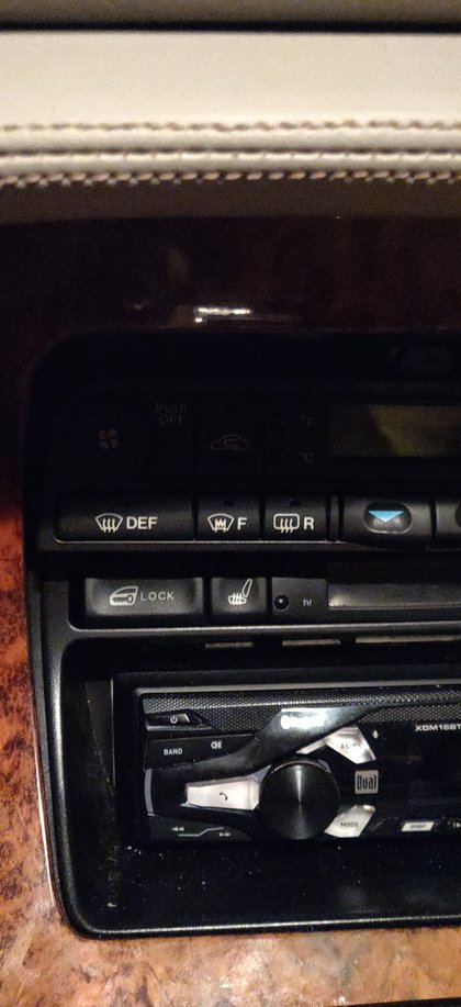

like this? Is my car actually Canadian?

Yes, those are both canadian-only standard options.
