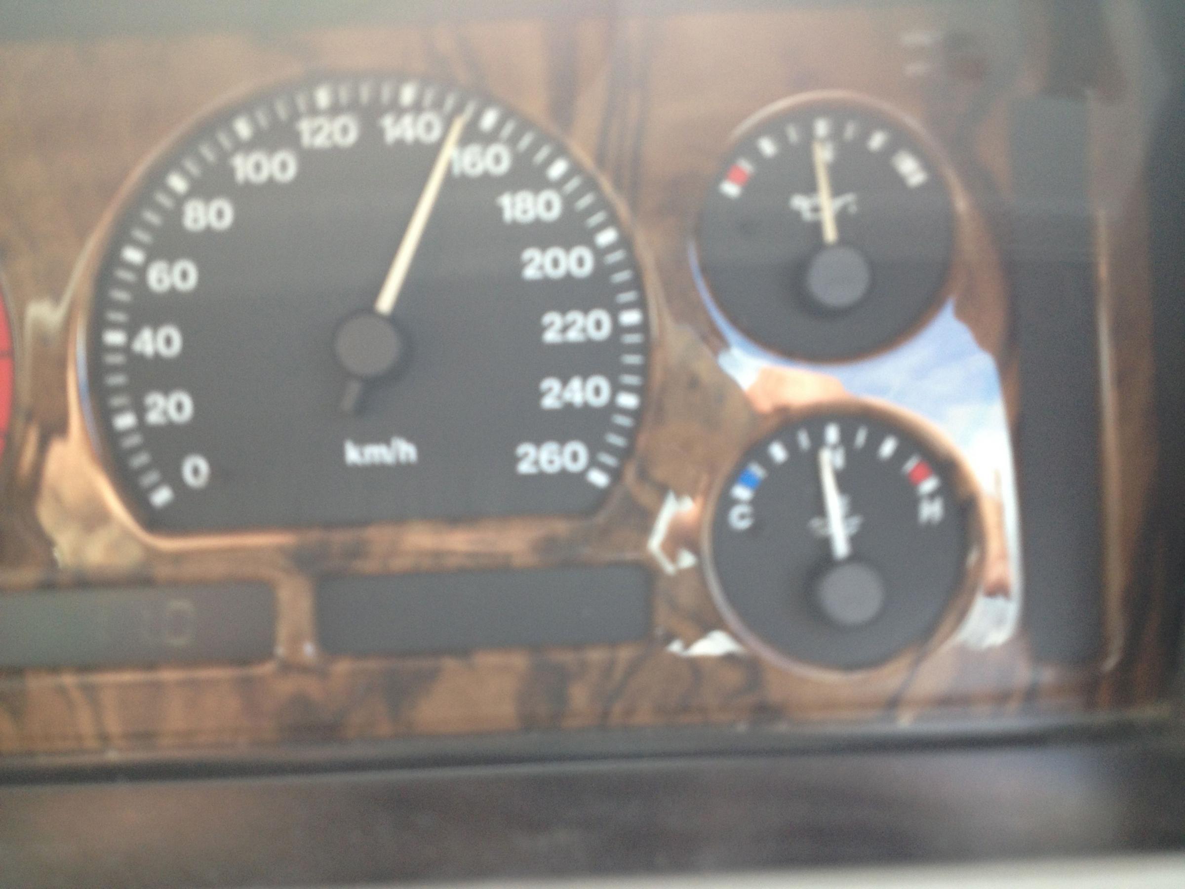

Default I love it when all gauges are on Normal..
Temp and oil pressure sit rock steady..

Yes, mine is the same, including the voltage gague. The fuel gague however, seems to drop rather too quickly. It would be nice if it sat "rock steady" for just a little bit longer!

I hate to burst bubbles, but.....
You DO know those temp and oil pressure gauges are the "fixed reading" type, right?
The oil pressure gauge reads "normal", and the needle remains fixed, at anything over about 5 psi.
The temp gauge is designed to give a normal reading over a wide range of operating temperatures. On mine, for instance, the needle hit "N" at 174ºF and stays fixed until at least 206ºF. Not sure at what point it flops over to "Hot".
I'll add that a handful of early 1995 X300s had a true oil pressure gauge.

bubble burst, Doug!
I have noticed the temp gauge rises, as the engine warms, in small increments of 1-2 mm, then sits at lower edge of "N". That would explain it.

umm ... 150 km/h is normal? Better not have that picture in your wallet when pulled over

Must've been raining or a dirt road.
