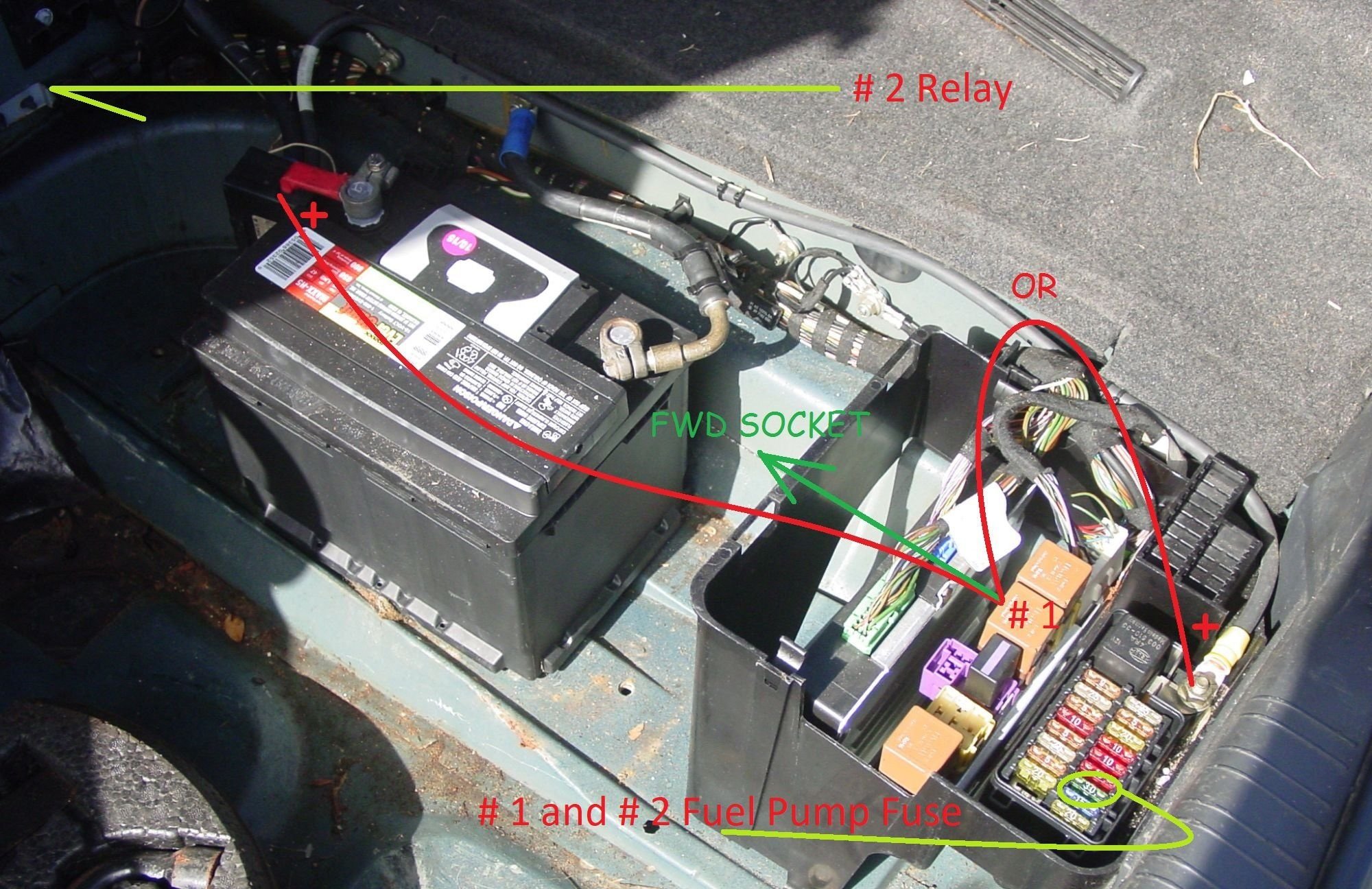

The fuel pump relay can be jumped on the fwd most socket to the aft most socket and this will bypass the fuel enable circuit and directly power the pump
The pump will run at all times with your key in your pocket so plan accordingly
use a blade type connector on the jumper and not just jamming a wire into the sockets
by removing the relay you bypass the relay contact points inside that can be burnt or the relay contacts floating
Look at the connector on the fuel pump itself for burnt sockets , this is a sign the fuel pump is giving out
The relay can be swapped
the circuit depends on the CKPS sensor which you changed but ........
The relay is powered by a fuse # 10 in the right heelboard fuse box and a controlled ground ( enable ) from the engine ECU closes the fuel pump relay
This fuse relies on the king relay in the corner of the fuse box to close and can be swapped with the one in the left engine bay fuse box because in reality it only controls the horn
The relay is at point 7 circle double hash in the pic below
The temp sensor for closed loop ECU regulation is the 2 wire sensor
Sorry to say the pump can be bad even though new
In changing the pump it is recommended to change the relay also along with pump connector inspection
