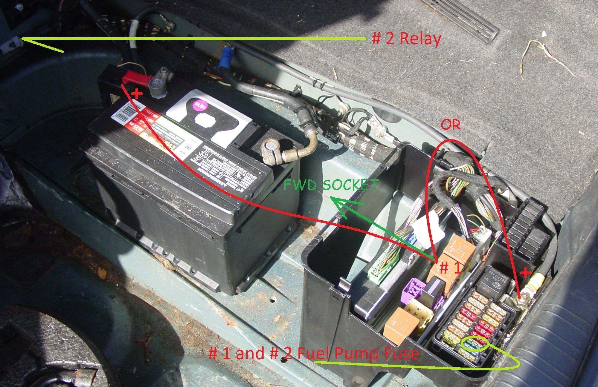

Being that i live alone can i pull the fuel pump fuse tuen the ignition to position two then return to the trunk and reinsert the fuse to hear the fuel pump pressurize? Thanks

the fuel pump will come on for 3 seconds only , this " charges " the fuel lines and not a priming of the cylinders . Hold foot off pedal as pumping the pedal does nothing . Holding the pedal to floor will cut off the injectors by design
The fuel pump will come back on when the CKPS sees engine rotation , safety design
This holding to floor is one way to re establish the oil film on the cylinder walls , this is the walls get into a bore wash condition which does happen
The fuel pump can be powered on by jumping the socket 3 ( Hot at all times battery ) to 5 ( pump motor )
This will drain battery with keys in pocket , this is also a stranded on side of road tool to keep in trunk
BEST MEDIUM GAUGE WIRE WITH BLADE TYPE WIRE END FOR BEST CONCUCTITY
