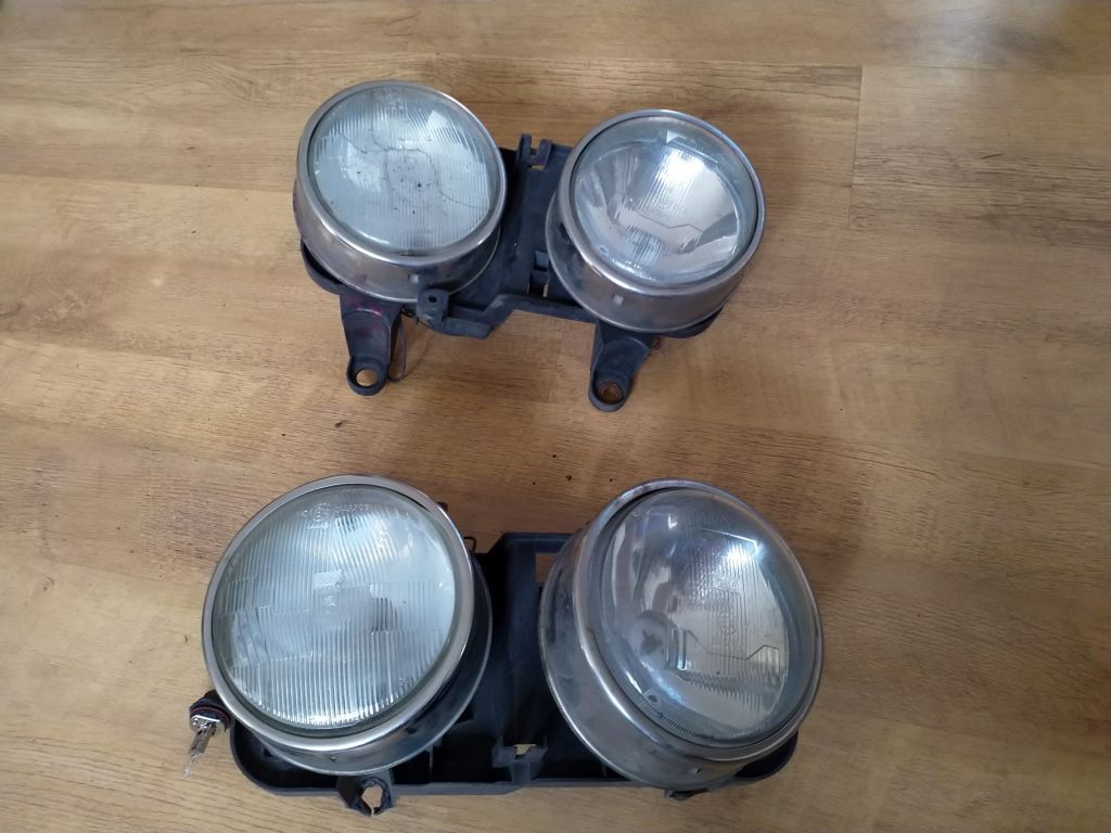

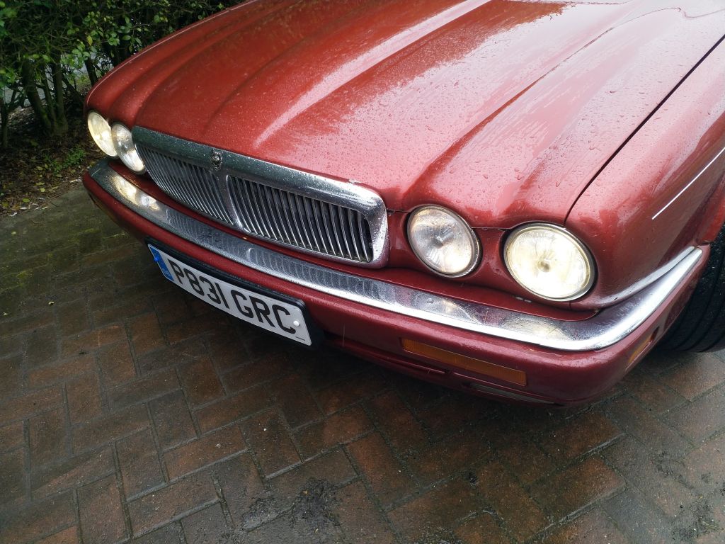

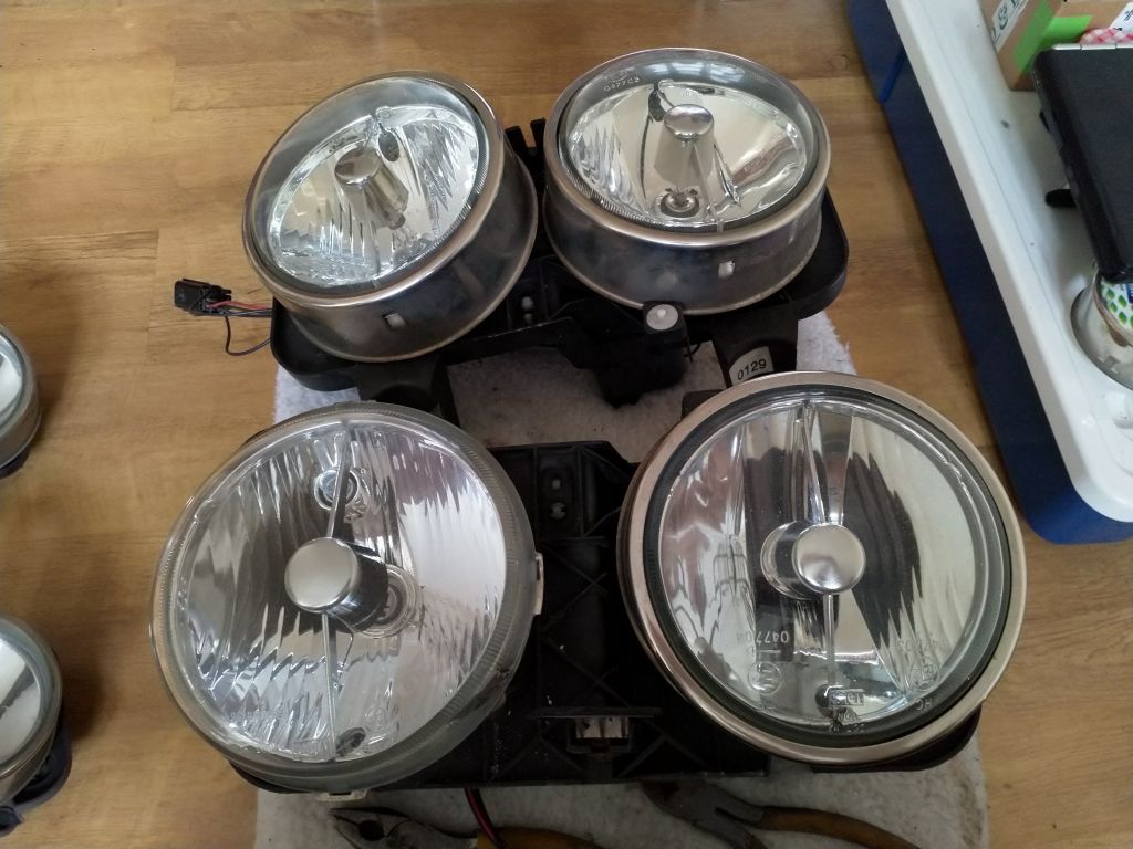

Well, not exactly joined the club but fitted x308 headlights to my x300
What a difference, I mean WHAT A DIFFERENCE! I can finally drive safely at night and enjoy it too!
Fitting them was super easy, pop the old ones out with a long flat screwdriver, transfer the lights plug to the x308 lights(they are different but pin location is exactly the same so easy to swap one cable at a time, 5 cables each side) and pop the new lights back on. One fixed aluminium mount snapped on mine so had to drill it out and fit another one from a spare frame but that was all the heavy work to do here. Will have to adjust them at some point as they seem to point a bit too high but what an improvement! I'm chuffed to bits!
All under $100 too
