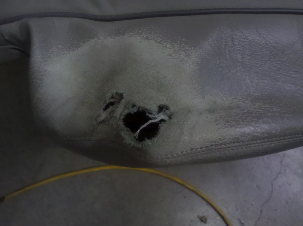

I set out to restore my seat heaters and get a hole in the side-bolster repaired:
Since I'd have to skin the seats to replace the heater blankets, I thought i might save a bit of $$ by taking the damaged cover to an upholsterer rather than the whole seat and/or car. Therefore I elected to start with the damaged driver's seat.

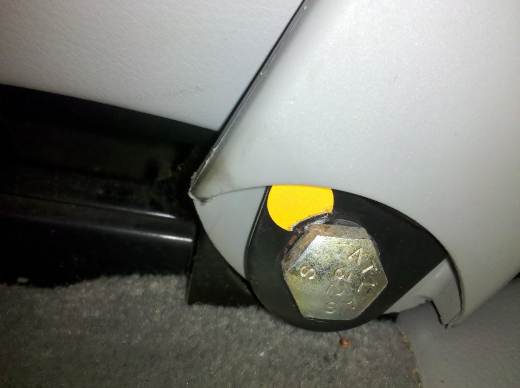

Removal is reasonably straightforward. Run the seat full aft and remove the 2 front fixing bolts (T-45 Torx) then translate it full forward. There are a couple of plastic frame covers in the way of the aft fixing bolts. They are secured by a single plastic "scrivet" on the inboard side of each frame rail. I believe it was a T-30.
Once those are out of the way, you can remove the aft fixing bolts with your T-45. To be honest, two of the bolts were substantially longer than the other two and I made a mental note that I would certainly remember which was front and which was rear (didn't plan to have the seat out quite as long as I did) but after surveying the situation on re-installation, I put the long ones in front - I beleive they would bottom-out in the rear. Now the only things tethering your seat are the seat belt and two wiring connectors. You can move it about in there and tilt it until you can bring your 18mm socket to bear on the seat belt fixing:

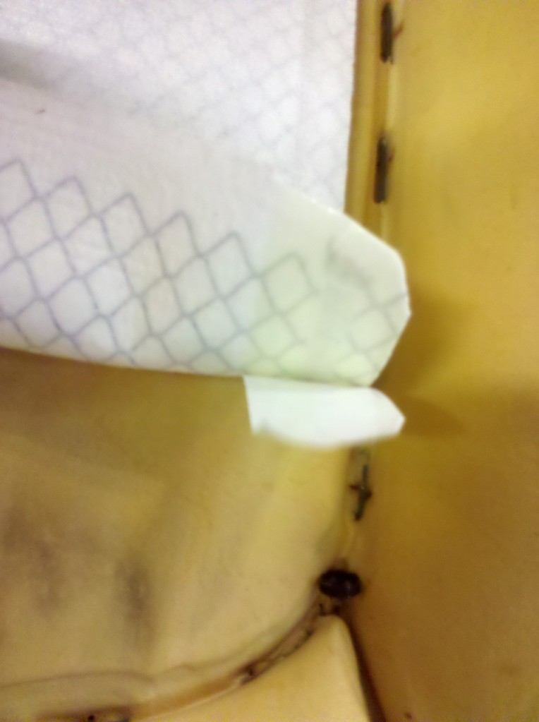

https://www.jaguarforums.com/forum/x...s-seat-101061/ ....but although I didn't, I could've sworn I broke something when it let go. The fore-aft and squab adjustment buttons went flying and the lumbar support adjustment button stayed affixed to the trim panel throughout. Here is a shot of what holds it on, and I noted during reassembly, it is possible to pry those two buttons off with a pair of o-ring retrieval picks if, say, you didn't get the trim panel to properly seat in the retaining clips near them. So "next time" (as-if) I'd probably try to lift those buttons out and more gingerly disengage those two retainers. Unfortunately, since the lumbar button was so content to stay, I never really bothered to see what would be required to remove it in order to get at the two retaining clips adjacent to it. Here is what's "behind the curtain:"
There is a retainer clip with hook facing outward (down) that you can't see in the photo just under the squab button at the bottom of the pic. It is identical to the one above the fore/aft button at the top, but the hook is facing down.
These bungee cords must be loosed from their moorings:
They are attached to wires secured in a fabric channel attached to the seat cover that engage the loop of wire running through your seat cushion. Much securing of the loose ends has been done with little spring clips, and despite similar appearance there are two different sizes; 12 of the smaller, and 8 of the larger. I took numerous shots of them in turn as I came to them during dis-assembly, thinking that would aid in re-assembly:
It didn't. What I should've done was take an overall view of the seat where those clips were visible, then, after removing those, take another overall shot showing the ones revealed by the removal of the previous - yes, in a kind of Chinese box arrrangement, each set of clips removed revealed another set of clips to be dealt with. The close-ups were of limited usefulness. I didn't even notice the variance in sizes until I started to re-assemble the cover to the seat and laid everything out and counted pieces.

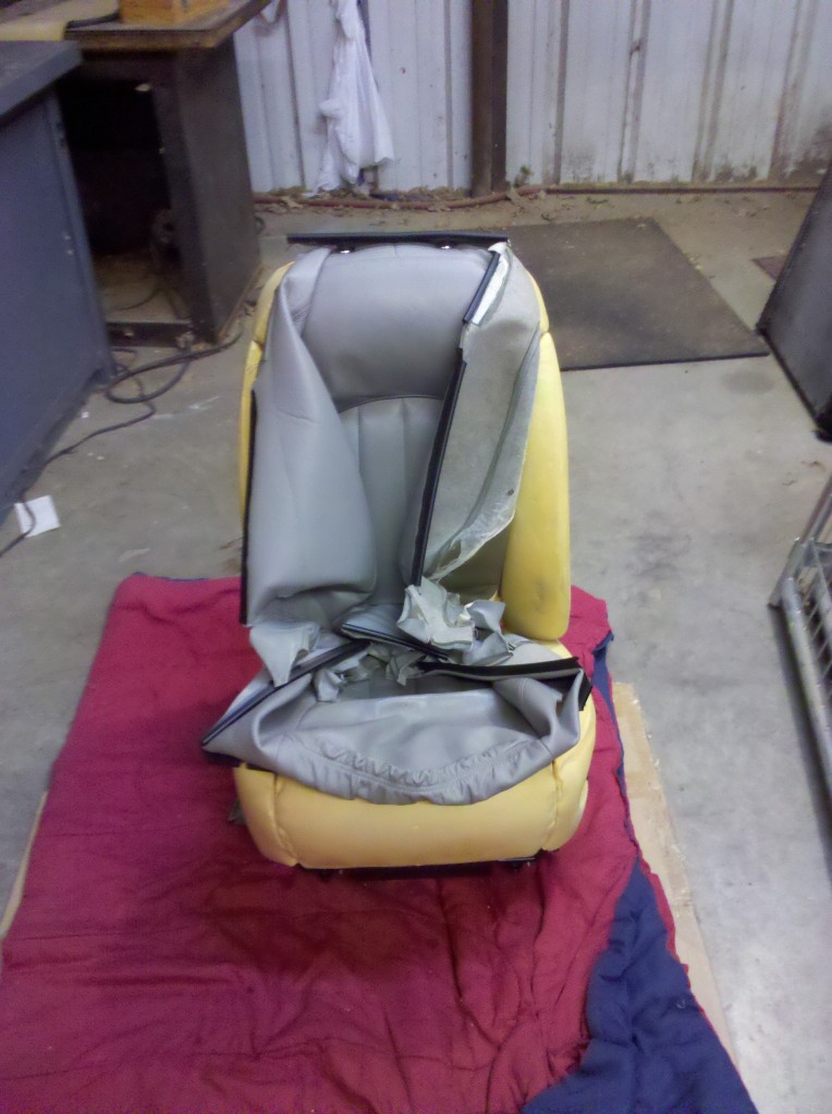

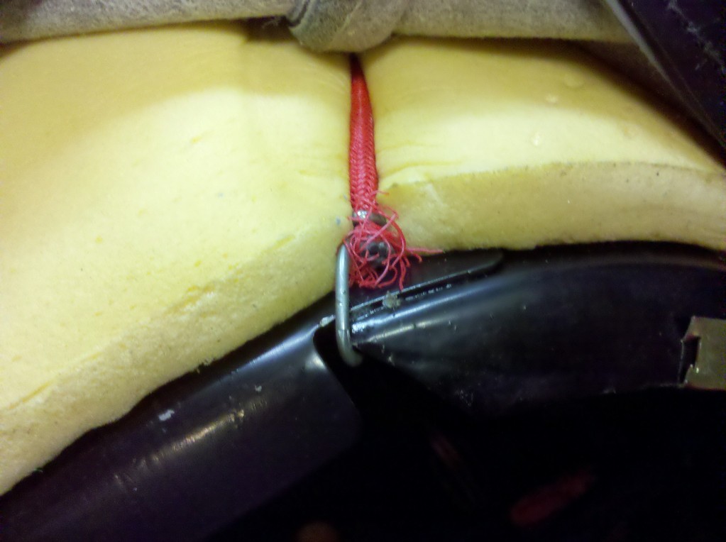

Once you have all the underbits loose, you need to pull them free from the hinge-point so that you have a bunch of loose cushion-cover material held snugly to the wire embedded in the cushion by hog-rings. This wire traces the same outline as the piping on your seat cover. Now, if you can take a picture like this, you're doing it wrong!
Fortunately, I realized my foul early-on and stopped ripping the wire up out of the cushion. You need to go 'round cutting the hog-rings with a pair of dykes (side-cutters, if you will) in order to liberate your seat cover from the seat. Same process for the squab with a few additional cautions covered below:

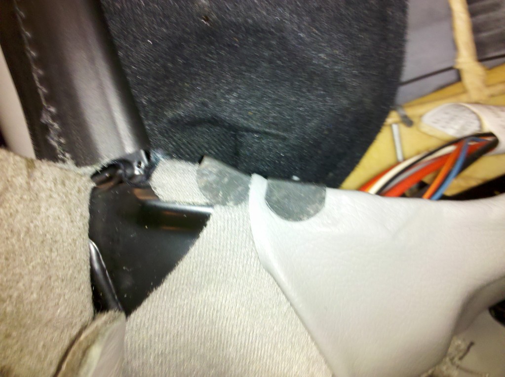

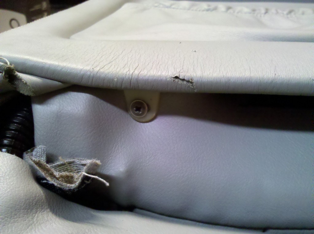

The squab cover is held on by two screws at the bottom, and four screws fixing the tray tables to the squab cover.
You can see the four tinnermans those screws engage in this photo. (on the brackets the red bungees are hooked to)

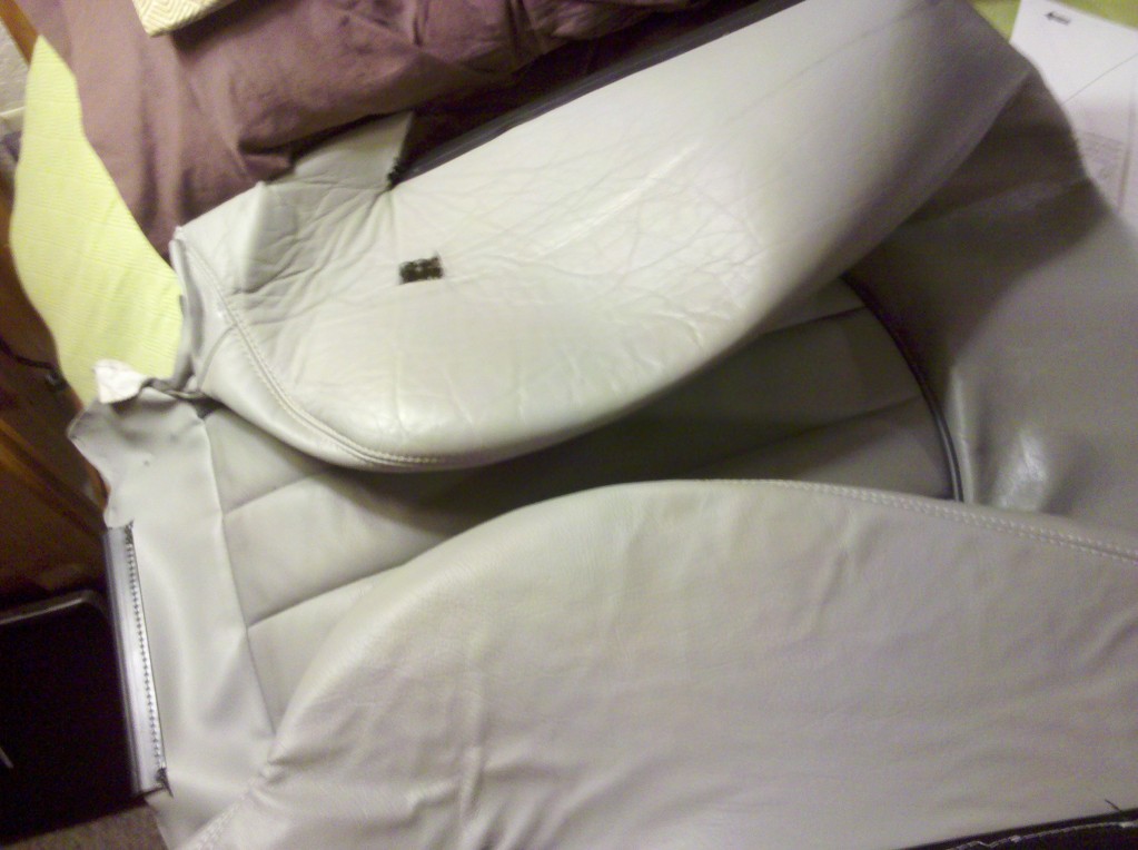

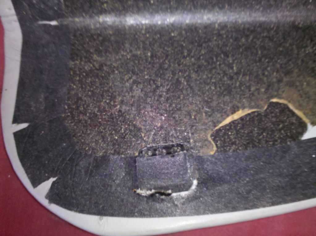

Having removed all the screws, now is not the time to employ brute force and awkwardness (as I did) and yank the cover from the squab like it is a recalcitrant turkey leg at Thanksgiving dinner unwilling to separate from the rest of the bird. Rather, you should push it in toward the seat, and spread the sides outward to disengage these clips, located low on the sides:

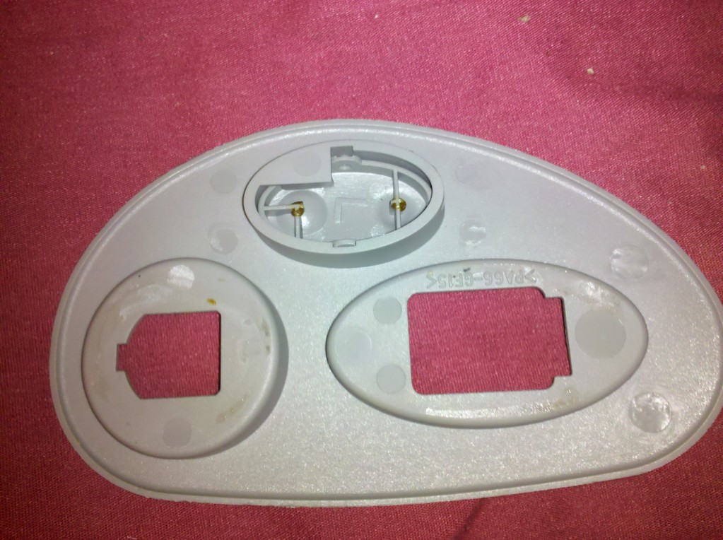

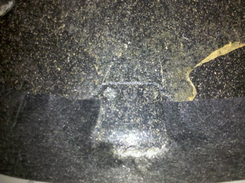

Fortunately, I had some fake J B Weld left over from my https://www.jaguarforums.com/forum/x...repair-102377/
to reattach the one that is supposed to be here:

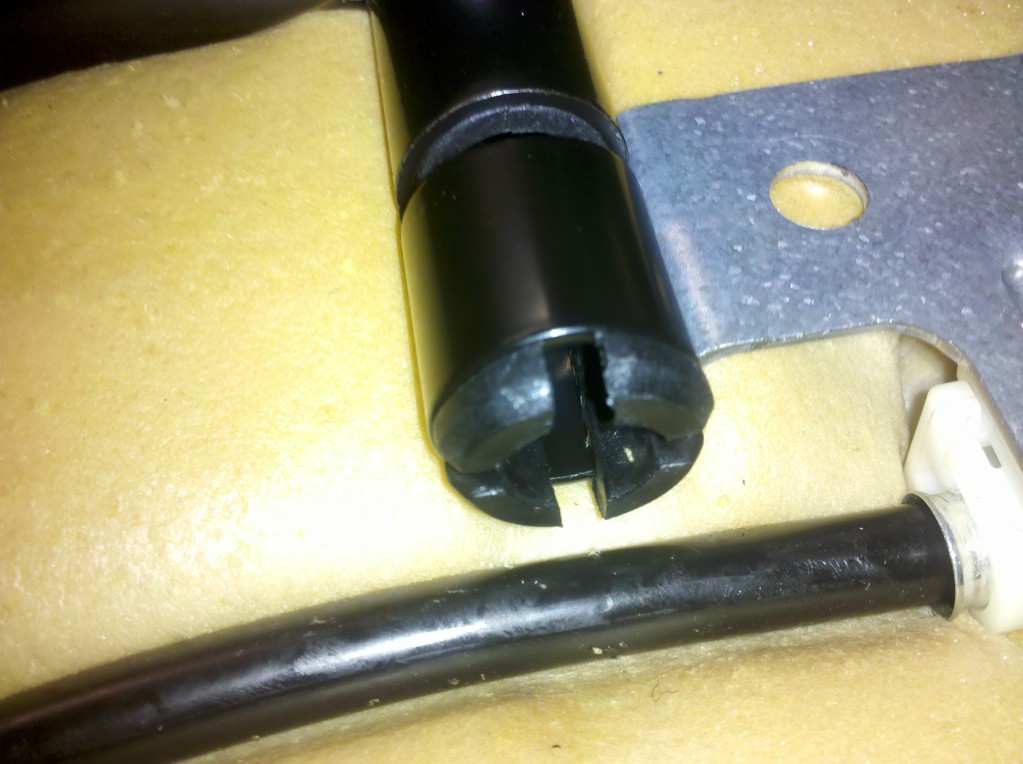

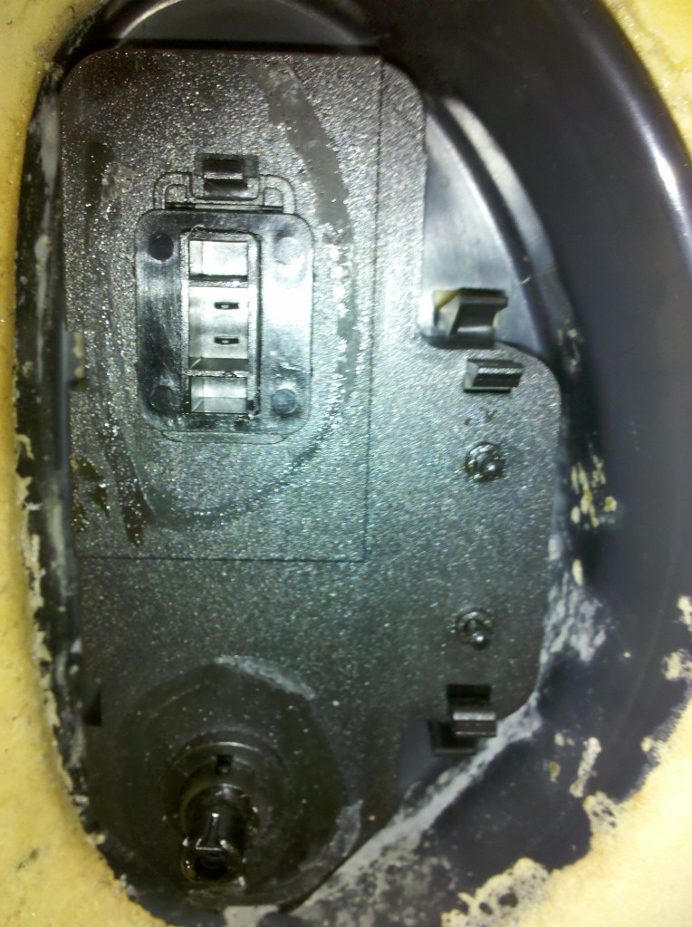

The headrest is removed with a "sharp upward pull" according to the manual, and that worked nicely:

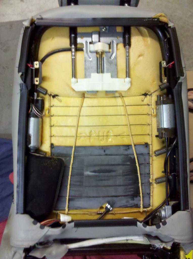

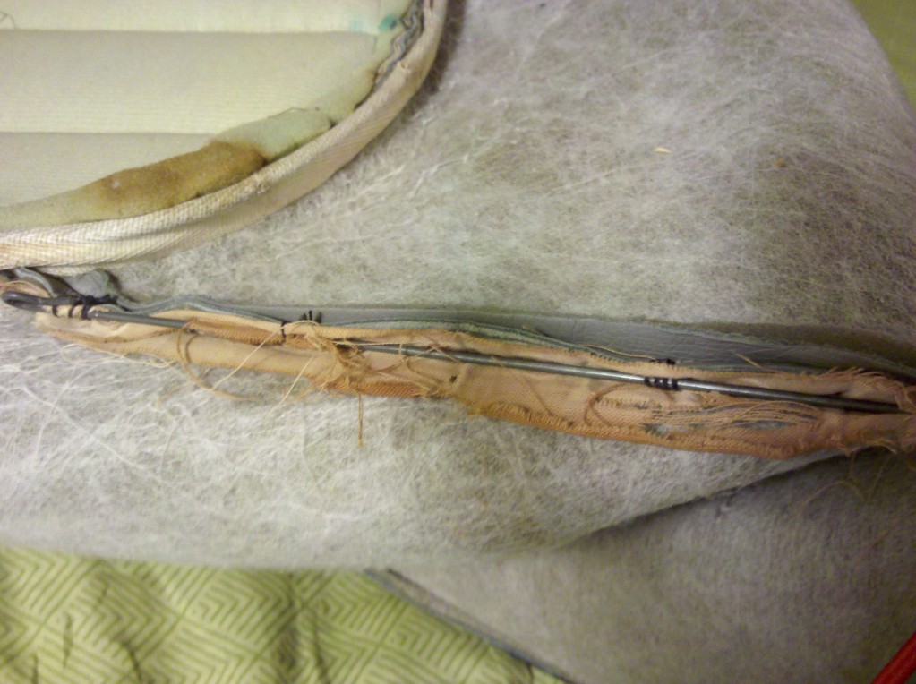

At this point in my discovery process, the leathers are held on by the hog-rings and the headrest trim covers:
I managed to get enough movement in the squab cover without ripping the wire our of the cushion material to raise it enough to disengage the headrest trim covers:
First, I squeezed these tabs:
which allowed these bits to pop up about "yay" high:
and you can see where the locking tabs need be actuated to disengage the trim rings from the rest of the mechanism:

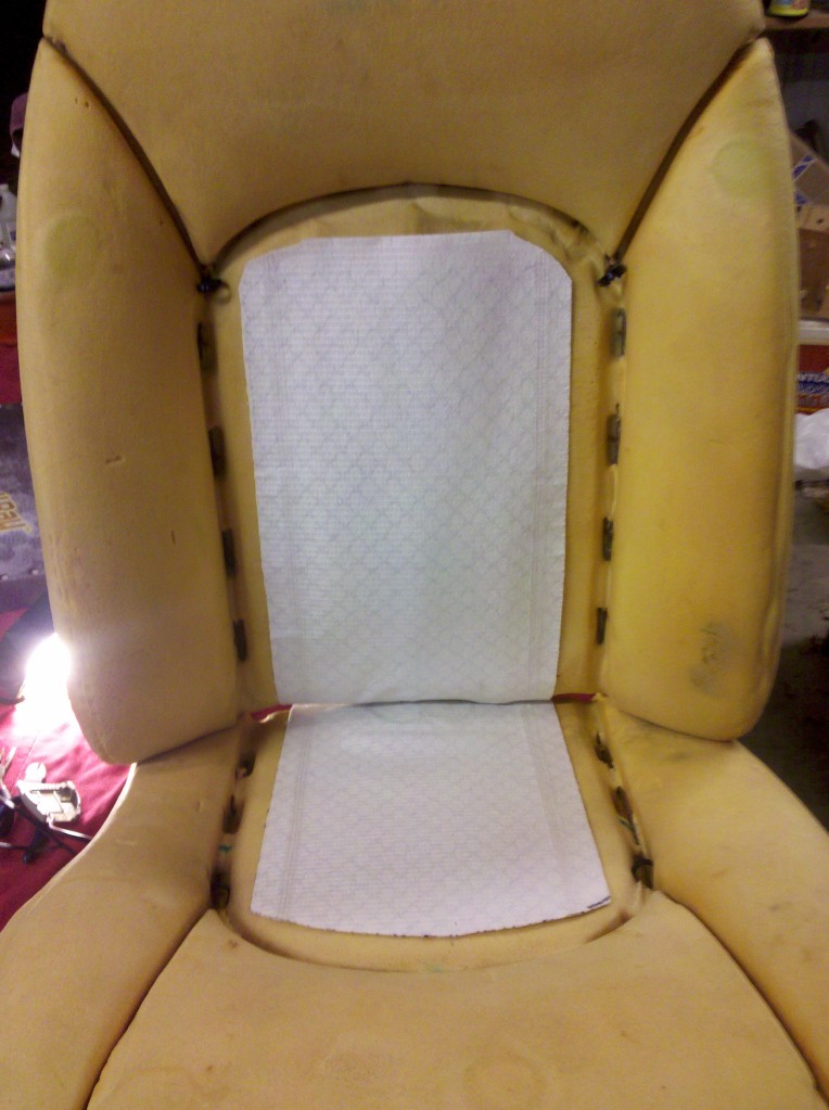

Now you can see the where the wires are embedded in the cushions and the reliefs provided for "hog-ringing":
By now you may be saying to yourself, if not to another, "I didn't see his old, inoperative heater blankets anywhere in this disassembly..." and you'd be correct. As it happens, I suppose my car never had them but perhaps a previous owner performed a clock-fix by fitting the heated-seats version of the clock panel. I know when I press the button, the red LED comes on, a relay clicks (under pax seat for that side, behind the dash somewhere for driver's side) and then after a number of minutes the red lights go out on their own. However, having bought an aftermarket seat-heater kit with intention of fitting the carbon-fibre blankets out of it to replace my inoperative (nee, nonexistent) ones, I modified my plan ever so slightly and soldiered on. Firstly, there will be no removal and skinning of the passenger seat! I decided to fit a couple of blankets to the driver's seat just in case someone ever replies to https://www.jaguarforums.com/forum/x...s-help-101802/ or I otherwise locate the circuits I'll hook them up. I'm not really interested in seat heaters in this car unless they are working from the proper dash buttons. I'll take the rest of the heated-seats kit and equip the driver's side of my Excursion one fine day.

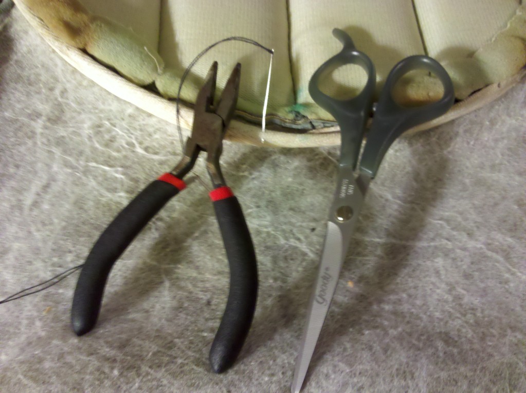

As the material that came with the kit indicated you could trim them back to 12", but did not really address whether or not you could cut holes in them, and was rather specific that you should not allow metal bits anywhere near them, I decided to trim them to just fit beneath the piping boundaries:

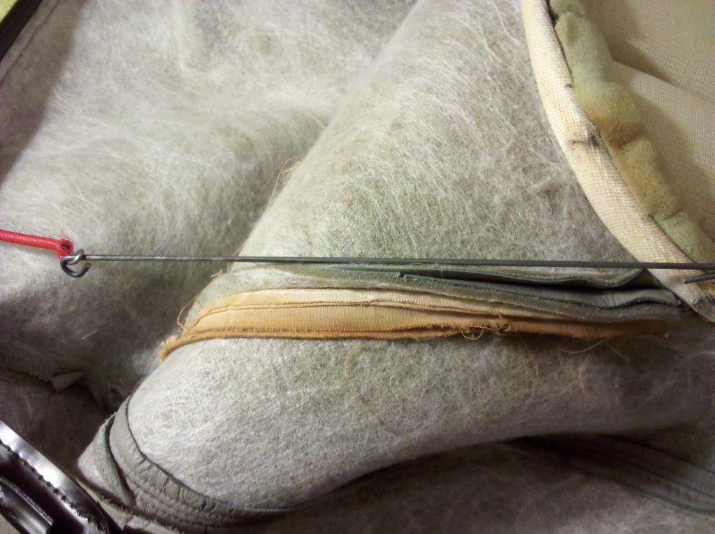

While sitting around waiting for two precious panels to be replaced in my squab cover, I noted that the wire-bungee assemblies had escaped their sleeves in the cushion cover and set about to effect a home fix. Here are the tools I have chosen:
I quickly replaced the thimble I'd first chosen with the needle-nose pliers as it was otherwise impossible to start the needle into the leather, then pull it all the way through....but here is the problem I was facing:

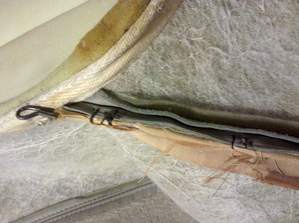

The wire is supposed to be encased in a sleeve of brown, gunny-sack like material that can be seen along the seam. I decided to cinch it up to the leather seam at 3 or 4 points along its length with thread:
There are two such wires on the cushion, and two on the squab. both were adrift on the cushion, but the ones on the squab were in fine nick.

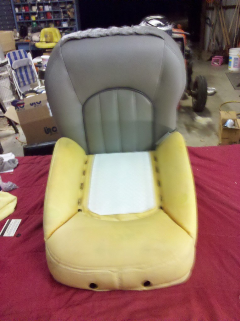

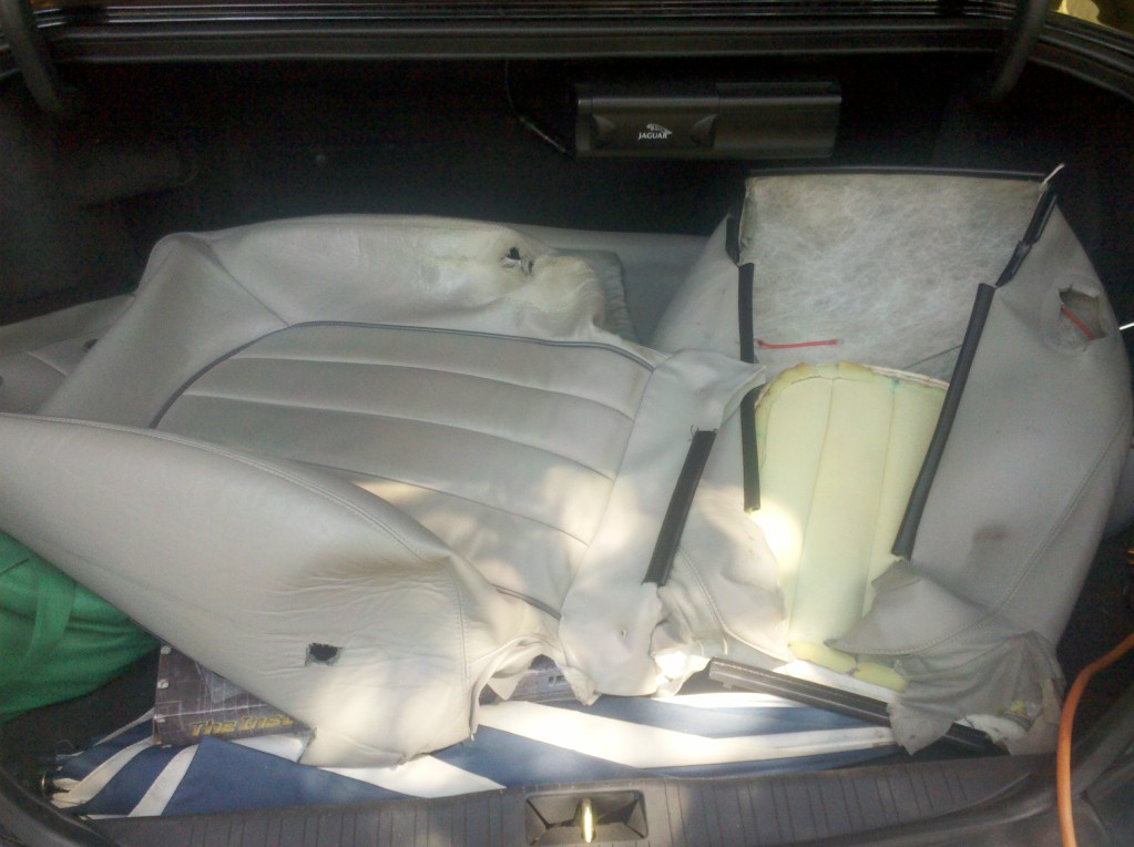

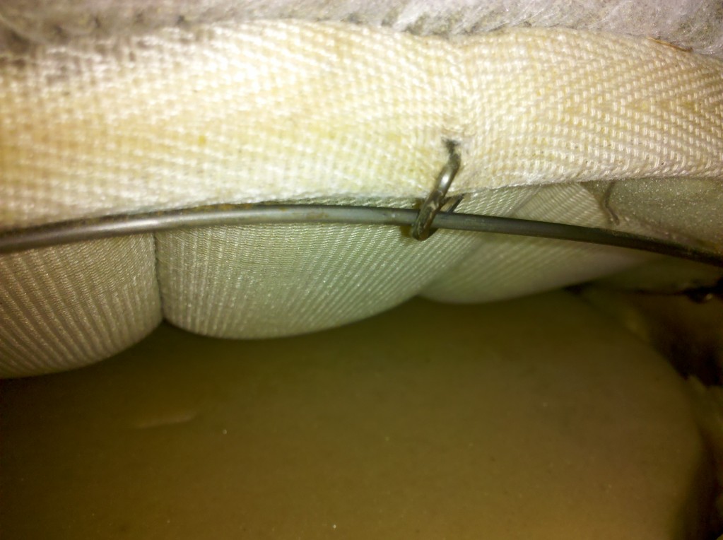

To recover your seats, first hog-ring the wires in the seat covers to the wires in the foam.
Hog-ring pliers and an un-used hog ring. You can see one I've already installed just lower and right of center in the photo:

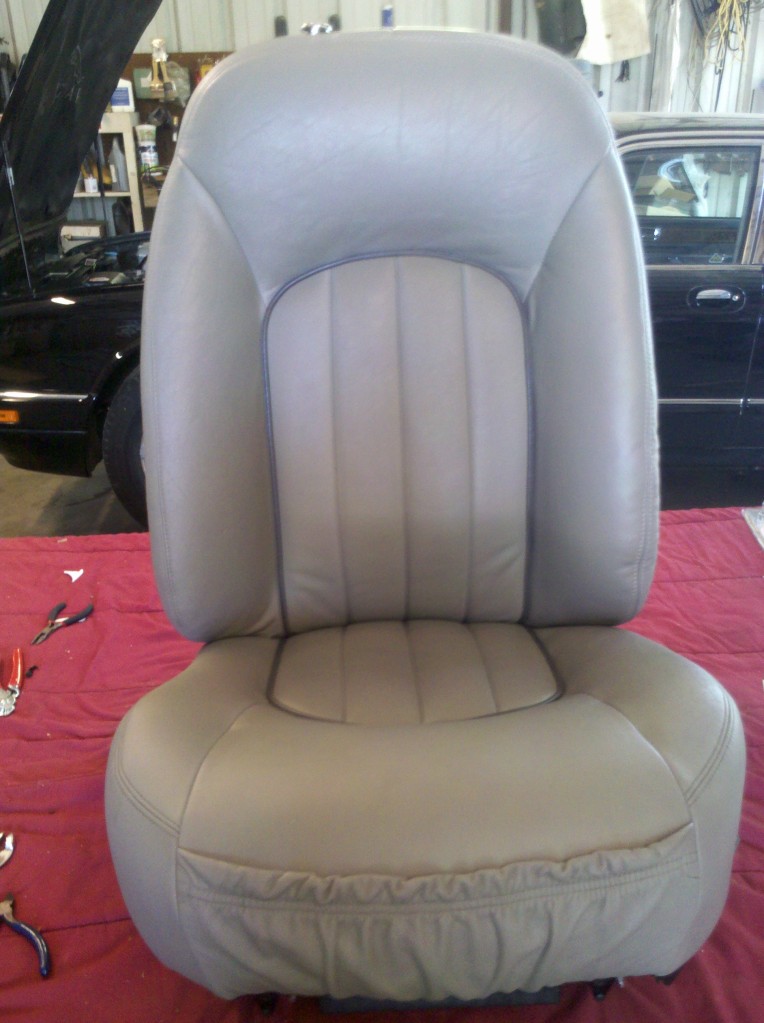

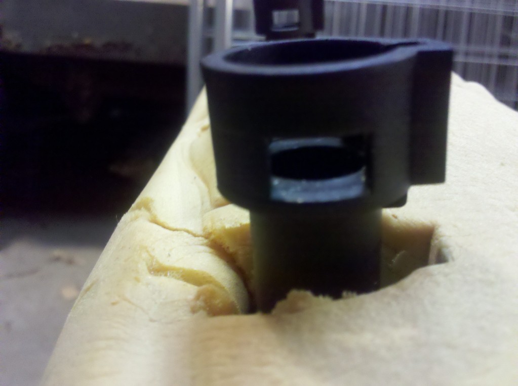

I led off with the lower cushion, thinking, "the only change it has undergone is being slathered in Gliptone for 2 or 3 weeks, the thin carbon fiber heater blanket, and slightly tighter "guy wires." Oh, wait, remember I'd ripped the wire out of the cushion around the entire arc in the front, better address that. I noticed when skinning the squab, Jaguar had seen fit to zip-tie the wire embedded in the cushion to a wire frame on the back of the foam at the location where the red-bungee wires hook to it. Finding a similar wire grid under the seat cushion, I decided to pre-install a few zip ties in the lower cushion at each bungee wire tie-in and again as close to the middle of the arc as I could get. My initial attempt was to just stab the pointy end through from the bottom, but on the rare try that it worked to exit the top of the cushion rather than just curl up somewhere inside the foam, it never came out where I wanted it. I had a set of long, thin, pointed shop tweezers courtesy of one of those Hazard Fraught stops back when my office was in Hurst. I held them together, poked the pointy-end down from top to bottom on the proper side of the wire, then spread the tips slightly with a very small screwdriver and fit the pointed end of the zip tie in there. Holding together tightly on the tweezers, and pushing the zip tie near to the foam face brought it out the top surface in fine fashion. Then, I moved my tweezers to the proper side of one of the wires on the bottom grid, stabbed 'em back up through, from bottom to top, arc'd the pointy end of the zip tie around and installed it to the tweezers again. Unfortunately, I failed to take a good pic of this, but you can see one in the lower right portion of this photo:
All done but the shouting for the bottom cushion, you can see some slight dimples where I cinched the wires down tightly to the cover, but short of access to a para-rigger's heavy duty sewing machine to run a new linen channel along the whole seam, I'll take it!

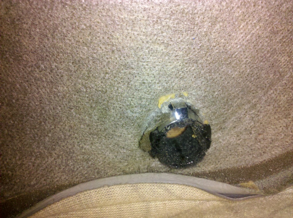

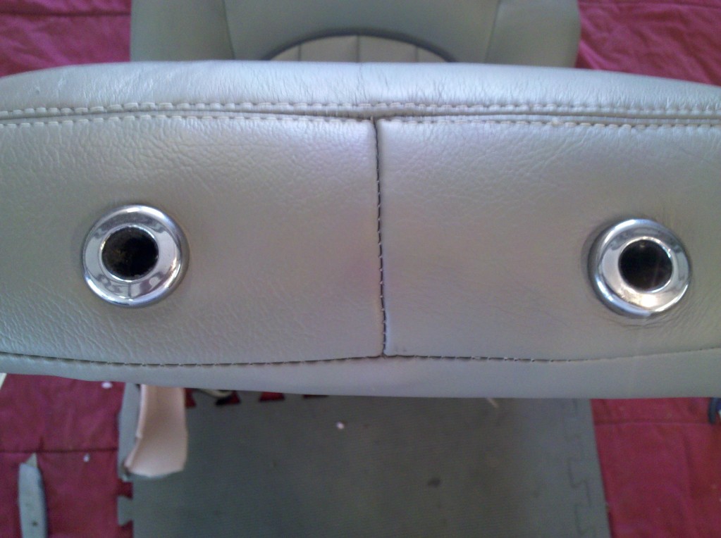

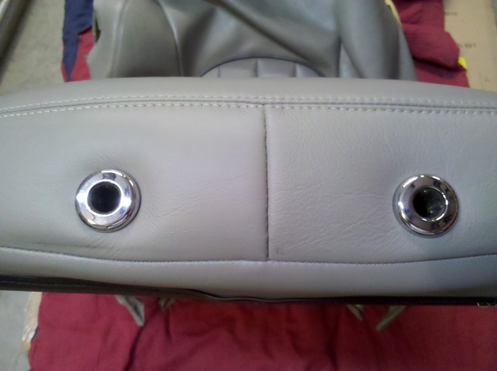

The guys at the upholstery shop were kind enough to mark where the hole for the headrest should go:
But in my zeal to "do something" when I finally got home with it from a business trip, and yet feeling too tired to attempt reinstallation of either cover, I elected to subject it to an intense cleaning and conditioning with Gliptone, as the cushion cover had already experienced. Bye-bye markings, never even crossed my mind.
However, they didn't mark the other hole I'd need to cut, for the squab-cover clips as you can see in this one:
Nonetheless, neither hole was overly challenging once I had the cover on and connected at the back with the plastic clips. I did hold up doing the intricate wrap/clamp-with-spring-clips part until I had cut the holes and had everything in place.

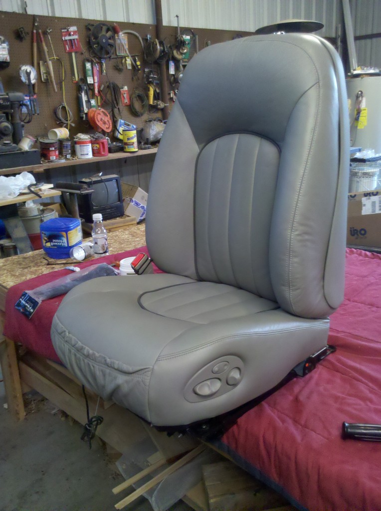

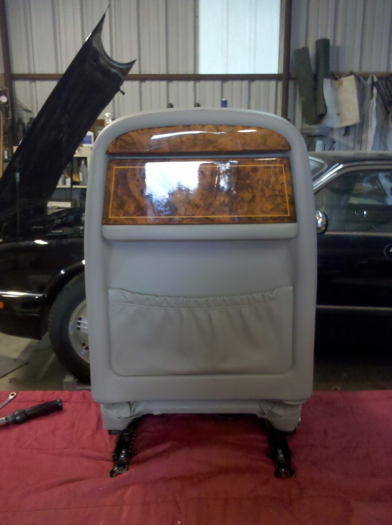

All's well that end's well:

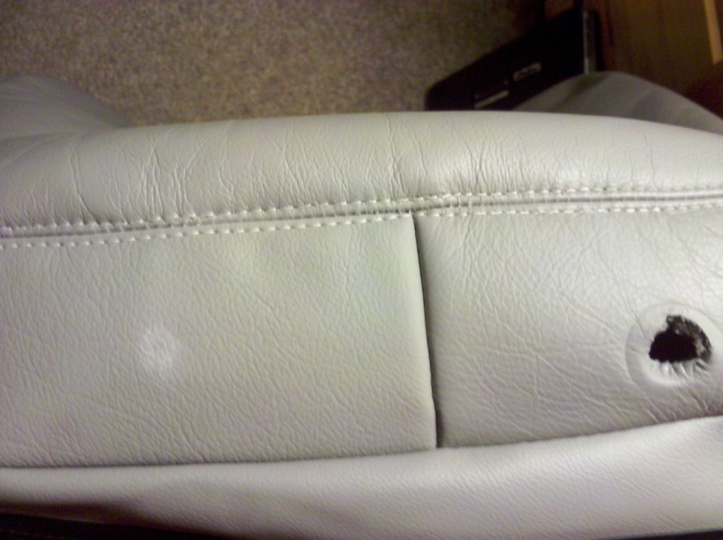

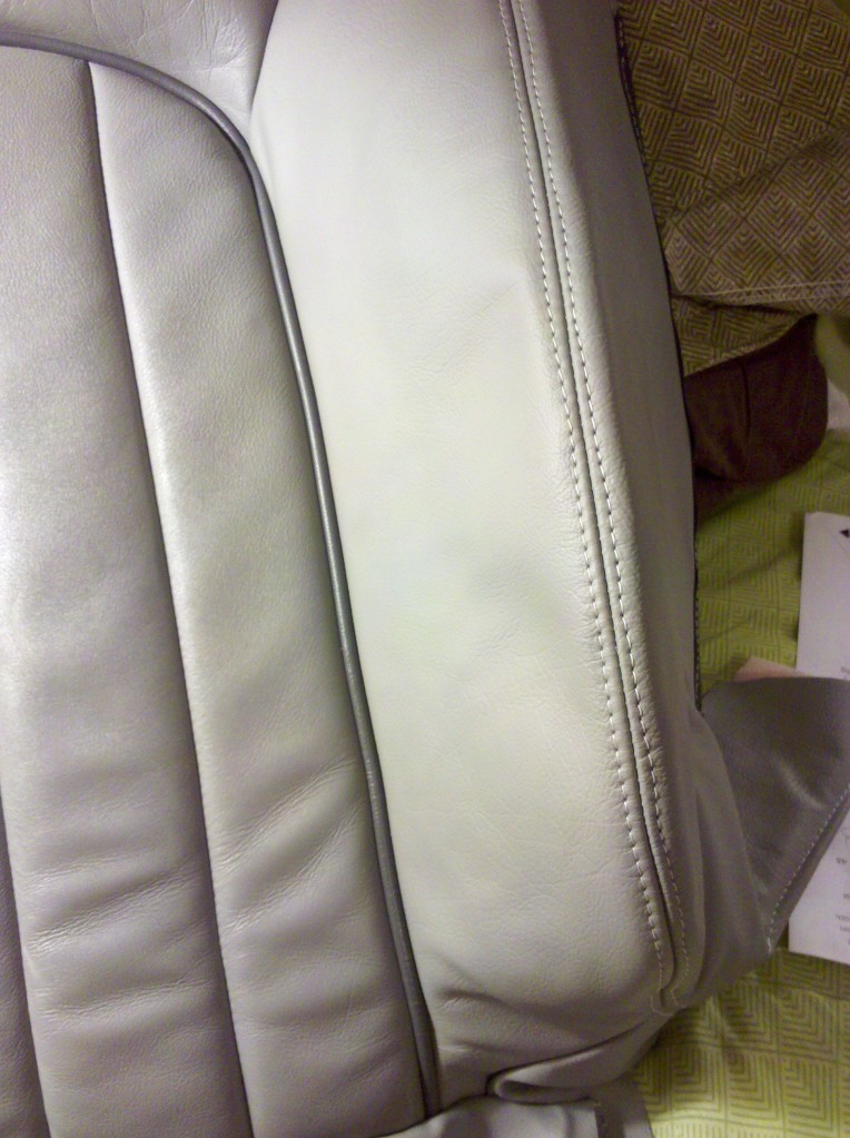

Perhaps the best before/after shot I have, is unfortunately, not of the damaged area, but the left panel containing the headrest trim bezel was replaced, along with the more-damaged face of the side bolster, so this gives you a good idea of how well it matched up:
Before:
After:
One final tip I forgot, I would recommend removing the seat-belt clip from the seat frame after you remove the seat from the car, paticularly if yours is like mine and the two haves of the plastic cover tend to separate if you look at them cross-wise. It has a couple of zip ties holding the wire on, and a fixing bolt for your T-45. But unplug and remove that bit and put it somewhere safe BEFORE you end up shattering the plastic cover into several pcs as you move the seat around while you are working on it. Then perhaps you won't be depending on plastic model cement and a couple of zip-ties to hold yours together. Trust me - good gouge, that.

OUCH!!! After interviewing a few upholsterers, I picked a shop today and it is near-as-makes-no-difference $500 to fix the hole....and that's with the cover already off the seat! I thought it would be cheaper. Can't escape the feeling that the price doubled when He asked if it went on a Lincoln? and I replied, "Jaguar." Anyway, will be a "week for the leather to come in, and a day to fix it." so I'll post up the finished pics in a week or two.

Got a call last Monday that it was ready; Exactly a week and a day from drop-off as promised. However, I was out of town until yesterday, so I dropped in on my way home from the airport and picked it up. Looks great to me.....I'll attempt to re-install it on the seat squab this weekend, as well as the cushion cover which is still off, and will post the finished pics. Last night I cleaned/conditioned it with Gliptone, and managed to re-install a flexible cable that had disengaged from the cushion front up/down motor, after first clamping the free-end in a drill and insuring that it would make the cushion move properly when spun.
Here is a little before/after teaser:

a little more tease: (still have to anchor the bottom of both covers at the back)
Attached Thumbnails Let's talk seats...upholstery?-img_20130914_115644_zps6ebdad65.jpg
