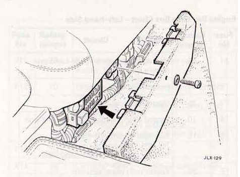

Hello Group,
Does anyone know the location of the relay used in the door lock system of the '95 XJ6? I have the early '95 XJ6 that has no glove box.
Thanks Everybody,
Carl

According to the Vehicle Care Handbook, in the passenger compartment behind the left hand side heelboard below the rear seat.
Relay has a Violet coloured case.
Attached Thumbnails Location of Door Lock Relay-x300-lh-heelboard-fuse-box.jpg

Graham,
Thanks for the tip. I removed the panel you indicated and saw three separate violet-colored cases that contain relays. One relay case in the center (containing two relays) and one case on the left and one on the right. The left and right cases contain one relay each. The identifier on the relays is LNA 6705 AA. Does your information identify which of these relays is associated with the door lock system?
Thanks much.
Carl
