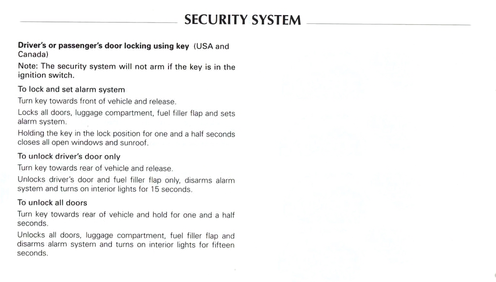

Here's the way it should work from the US Security Handbook:
Given that used remote fobs can be obtained cheaply and DIY reprogrammed, it could be the easiest way out of this dilemma.
Excellent Graham,
Thanks for this document.
Having trouble with my locks right now and this explains a lot
Bernie

Bernie,
It's rare to get a used Jaguar with a full set of keys (2 x Black headed Master + 1 x Green headed Valet) and remote fobs (2). Resolving this is a regular issue with many new members.
Add to that odd electrical issues resulting from poor batteries and the security/locking system can sometimes appear to be haunted!
