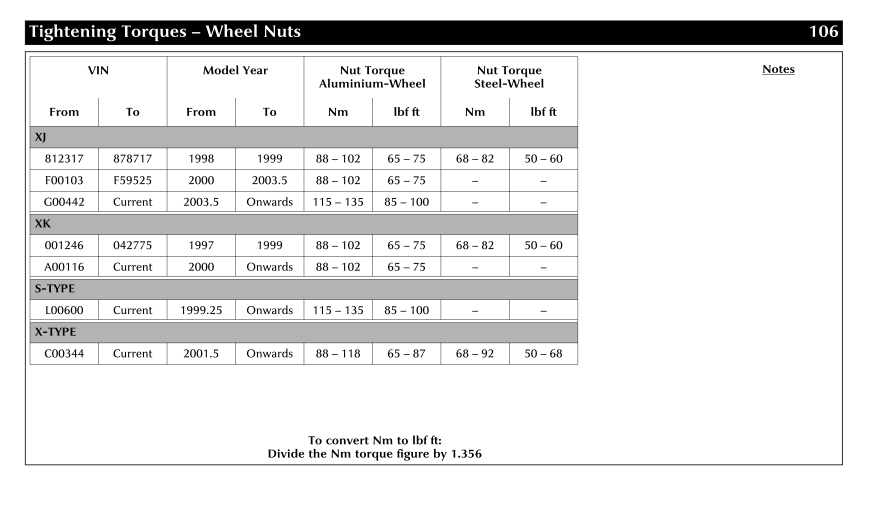

the handbook states 88-102 Nm for the nuts. He had set the torque wrench for about 120-130, so therein lies the problem, I think...
one stud has now stripped out of the hub - it fell out onto the floor of the tyre shop this morning. Another stud is spinning. So my rear wheel is held on by 3.1 wheel nuts at present.
I am sourcing a secondhand hub and getting it fixed next week.

All wheel nuts now at 70 lb-ft (manual recommends 65-75 lb-ft = 88-102 Nm). I think they were up around 120-130 Nm - way too tight
