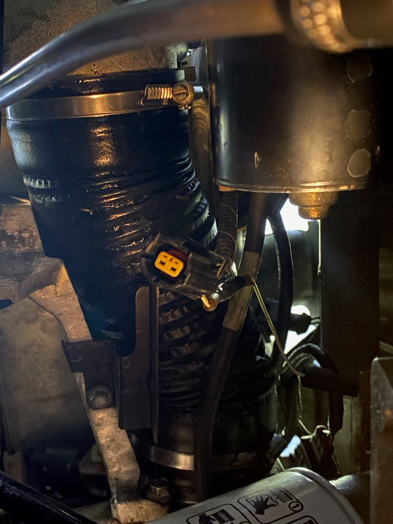

two wire female connector with red and black wires
Anyone know where the other male end is? Also any ideas on why the SC hose is so wet?

Single white wire looks like the starter solenoid command to close
Without this connected you will have no starter
The other end will be on the top side grouped with 2 of the same looking/ 4 wire O2 sensor connectors.
This will probable be on the rear of the valve cover on the left side
Do not mix the 2 02 sensor connectors as they will fit either position.

Knock sensor? There are two, front and back, left side engine block.
Not sure if they have that sort of connector. I think so. Also that should be a red/blue wire combo, are you sure you are seeing red/black?
Oil underneath the hose, probably inside the intake due to engine venting.

The knock sensor connectors will have the metal bar that you press on to release from the sensor
It is certainly in the area and if the knock sensor it will be a EV1 series connector like the throttle position sensor or a fuel injector
Your SC engine has these other sensors as an example buried in your supercharger installation so another EV1 connector is the trunk dome lights as an example
