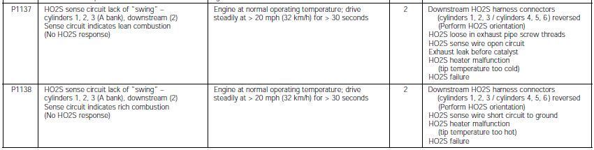

Hi BluuJaag,
What codes were present prior to your replacement of one of the O2 sensors, and which sensor did you replace?
I am attaching the Diagnostic Trouble Code Summaries for your car, which give Jaguar's definitions and possible causes of each DTC, which are often different from the generic definitions. Here's what the manual has to say about your current codes:
Since the O2 sensor connectors are identical, a common problem is connecting the Bank 1 sensor to the Bank 2 sensor harness, and vice versa. You might try reversing the connectors for the two downstream O2 sensors, clear the DTCs and see if they recur.
Your whining fuel pump certainly sounds like a good suspect and an obstructed fuel filter can cause premature pump failure. I heartily heap dittos on Cafcpete's and Grant's recommendations.
Other possible causes of your symptoms that come to mind are a failing Crankshaft Position Sensor (CKPS), which is known to have heat-related failure modes, and a failing Engine Coolant Temperature Sensor (ECTS), which could be telling the Engine Control Module (ECM) that the engine is cold even once it reaches full operating temperature, prompting the ECM to continue to apply cold-start fuel enrichment even when the engine is hot, leading to over-rich running. Sometimes other components can exacerbate the problem, such as an obstructed air filter, stuck-open coolant thermostat, etc.
