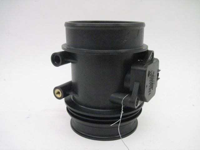

Old Mar 4, 2013 | 10:05 AM
Originally Posted by doowopfix
Anybody tell me where the maf(mass air flow) sensor is?............
It's in the Inlet Trunk next to the Air Filter (arrowed in red):
This is what it looks like off the vehicle:
