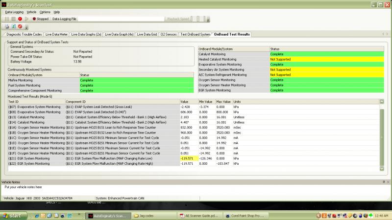

Have you got a mode06 page in your software?
If yes, I would be interested by knowing whare are the tests supported by this mode. With my soft, they are lot that are Jaguar specific and because not described in the international standard, not supported by my soft, even if the data are reported but without any information on the data measured.
Thanks,

here ya go, from an old test I ran.

Matt, you probably replied to my post https://www.jaguarforums.com/forum/s...-failed-87839/
The sw tool I use do not provide the detail that your does. I need to compare your plot with my records. I am affraid that the adress span of the list you provided stop at TID=22 (hex means 18 in decimal) when I am looking fo 53 (dec = 35 Hexadecimal).....
I will see.
