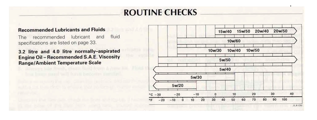

What oil should I use? Is 10W40 semy-synth good for this car?
I found a small bottle of 0W30 in the trunk, the previous owner probably used this to top up the oil. Will changing back to 10W40 cause trouble? As I got a 55 gallon oil barrel in my garage with 10W40…

The debate on Dyno/Semi-Synthetic/Full Synthetic goes on endlessly and it's really down to personal preference.
As shown in the Vehicle Care Handbook, 10W40 is suitable for the 3.2 litre:
If you don't use an OE Jaguar oil filter, make sure you get an aftermarket one with a non-return valve. This prevents drain back when the vehicle is standing and helps build up oil pressure quickly on start up.

OK - duly taken note of the oil debate. I'll use what I have, then. Question hereby answered.
