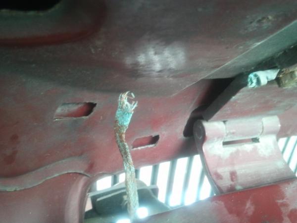

Hey folks does any one know what any of these plugs are
Attached Thumbnails Name those mystery plugs-1-chris-craddock-137431-albums-94-jaguar-xj6-7478-picture-does-anyone-know-what-3-pronged-plug-t.jpg   Name those mystery plugs-2-chris-craddock-137431-albums-94-jaguar-xj6-7478-picture-does-anyone-know-what-3-pronged-plug-n.jpg   Name those mystery plugs-3-chris-craddock-137431-albums-94-jaguar-xj6-7478-picture-some-kind-ground-cable-corroded-does-.jpg

So Am I missing a traction control unit (obviously)
Is it necessary to run???
the three pronged plug is behind the driver side headlight
and is very close to the third pic which seems to be some kinda ground from the hood to the chasis

Traction control not needed to run; it was optional equipment.
Dn't know about th other plug. It might also be for something your car nevr had to begin with.
