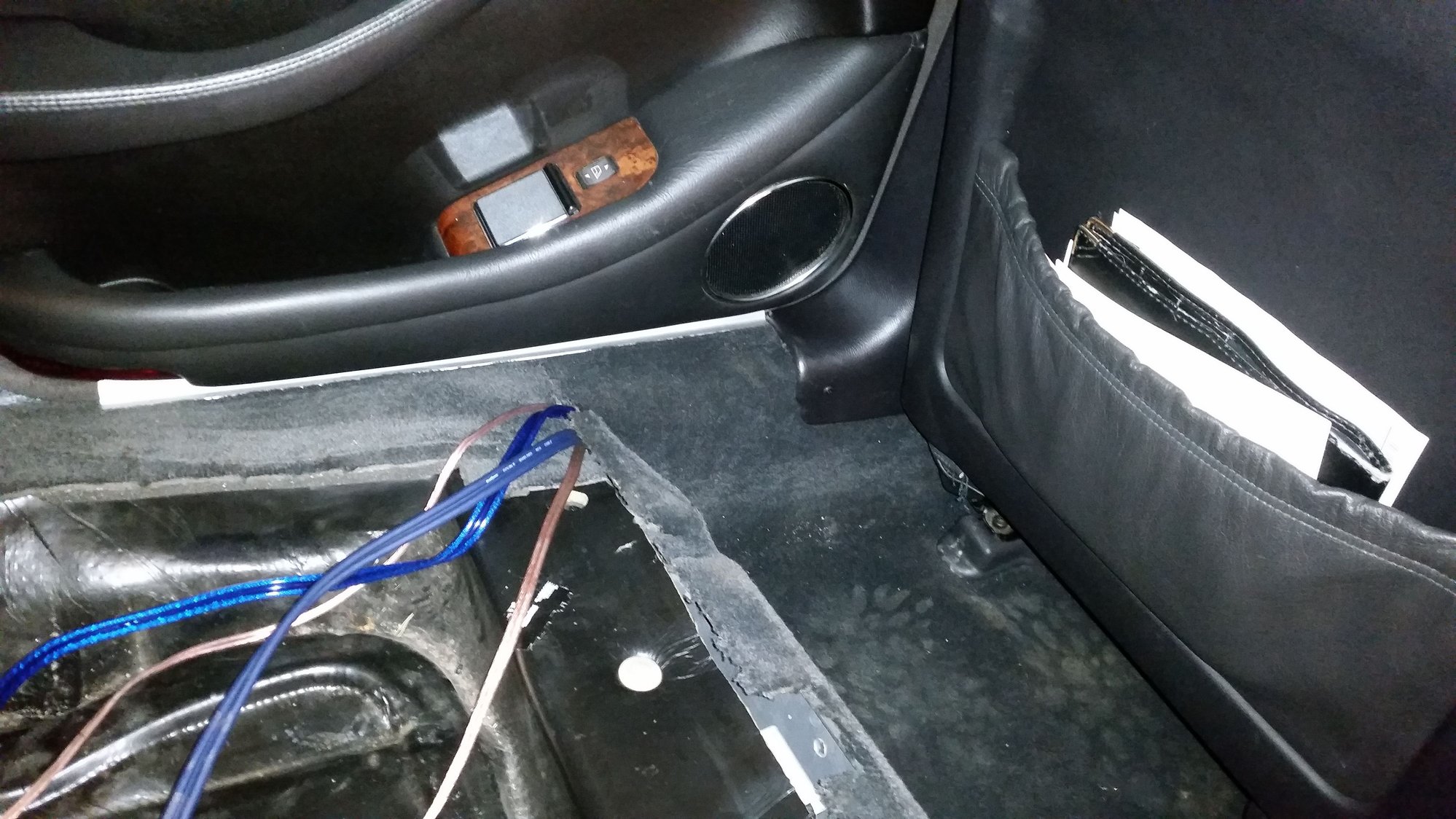

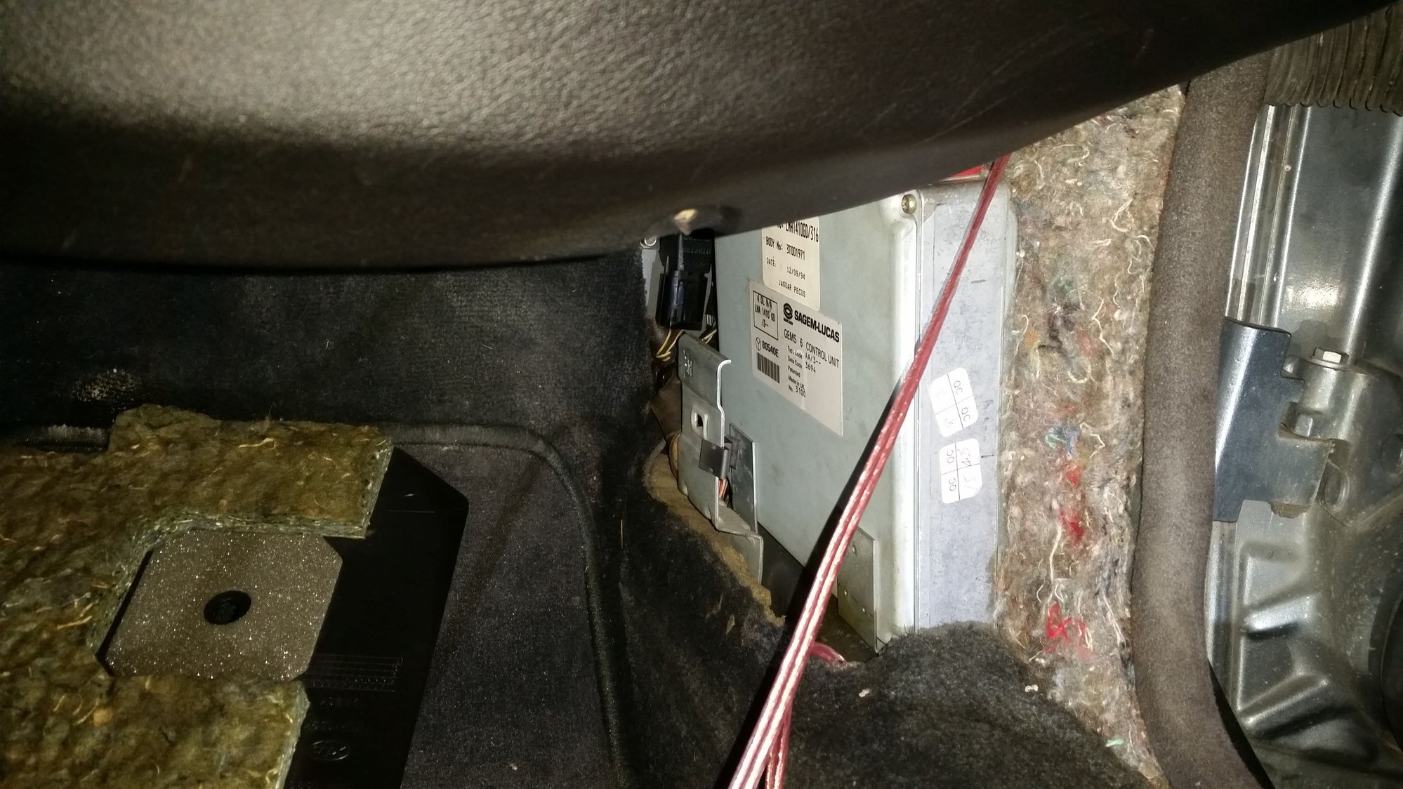

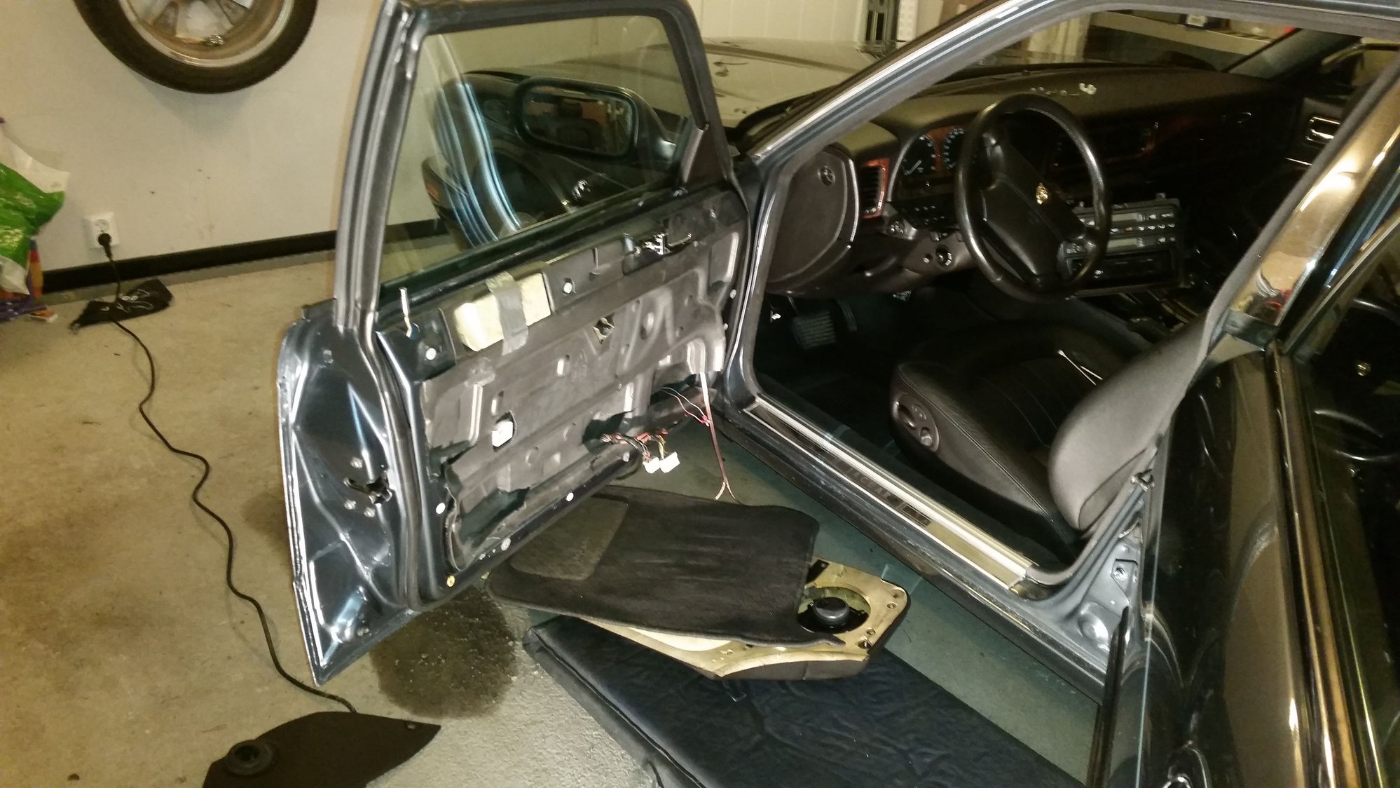

Spent a couple of evenings in the garage trying to sort out the speaker cables and rca cables. I purchased a fish tape and managed to pull the cables under the carpet. For the front doors I pulled new cables through the black rubber tube in the door but this was harder to do on the rear doors. Ended up splicing the original speaker cables from under the b post trim and hid everything under the carpet. Another evening and I'll be ready to hook it all up to the rockford amp.
"fishing for speaker wire"
Original speaker wire
A bit fiddly to get the wire through on this side.. not much space.
Rca cables pulled under the seat.. not visible when seat is in its normal position

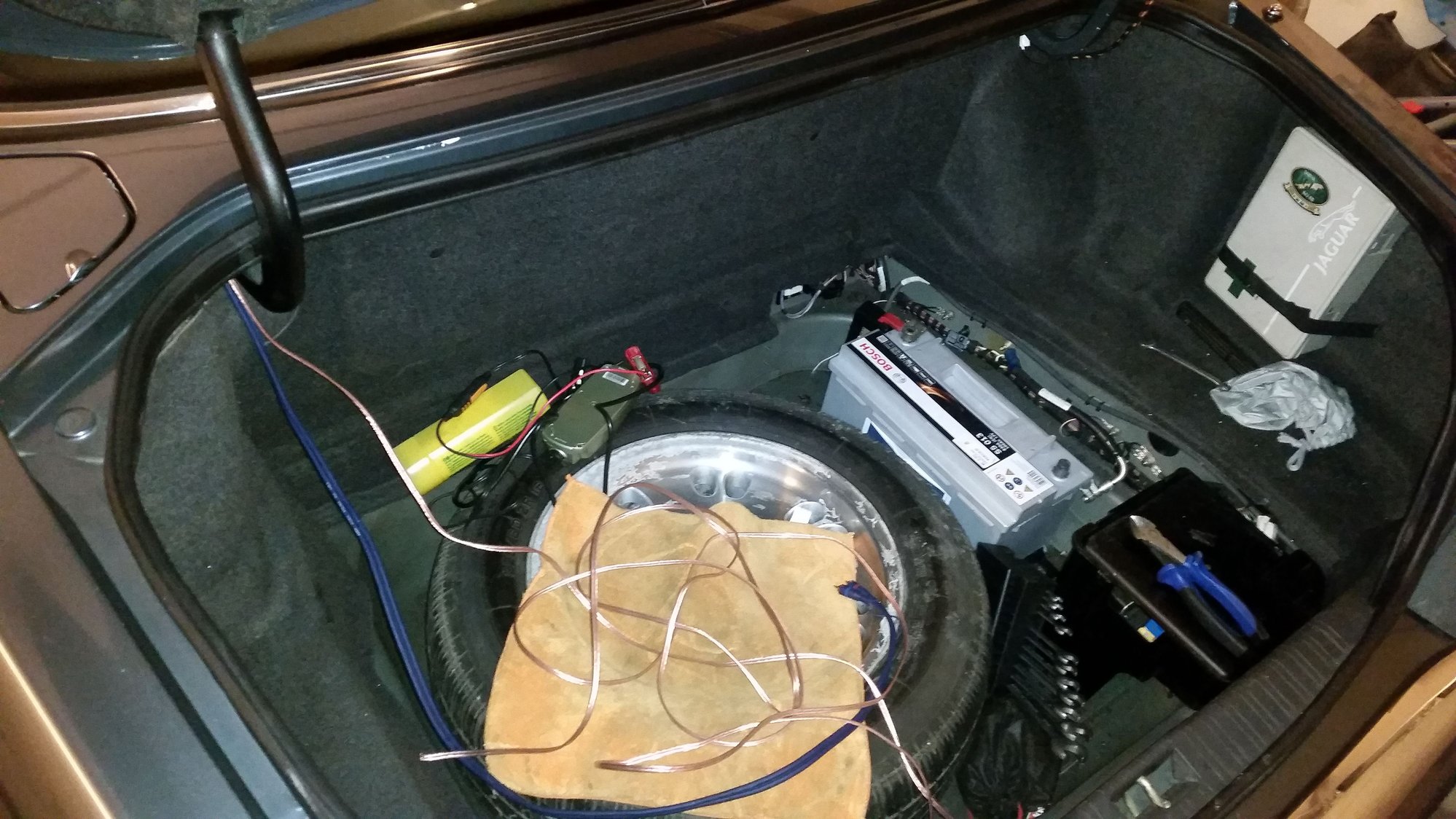

I ended up with an older rockford fosgate amp because of noise issues in the new amp.. 😐
But it sounds great and there are no visible cables anywhere. It was really nice to go for a drive now and get some quality sound in the car.
I might try to hide the amp away somewhere in the boot. It's a bit massive. I have also prepared cables for a subwoofer so it's to ready to install later if I want to.
