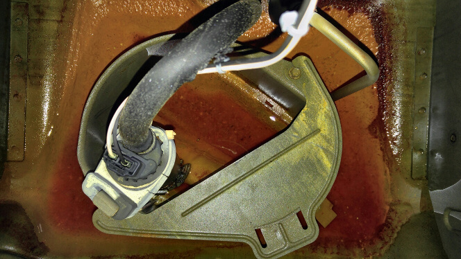

Thanks.. that was "easy"... Packin up for the night, will play more tomorrow, but I looked inside to see what I'm up against. I hope I can clean this rust stuff out. Any suggestions on what to use? Not sure if its caked on, or loose, maybe just pouring the last bit of gas out will get rid of most of it, then flush a fresh gallon or two?

Ewwe....nasty! Mine didn't look anything like that, I'm happy to say....(sorry for you) A magnetic LED flashlight will be quite helpful to illuminate the work area (but don't leave it inside when you button up) You may also want to remove the sending unit - another locking ring on the back of the tank - to get that out of your way and provide additional light. Doesn't look to me like that row of corrosion along the upper-right of the photo will drain out with the fuel. I'd start with a plastic scraper because a wire brush can make sparks. However, I don't hold out much hope for its success...you'll probably end up with something more abrasive, just remember you have fuel fumes there in an enclosed space.
There may be a shop that specializes in cleansing fuel tanks of such gunk, and they should be reasonable given you have the tank out.

That was terrible, much worse than mine. Can't imagine how the inside of the fuel pipes look like downstream beyond the fuel filter. Agree with aholbro1 that it had better be cleared and cleaned by the professionals while you have the tank out.
