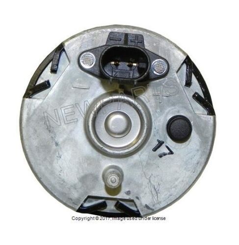

Bosch # 0 392 022 010
Any adaption hints ?

I cut the front of the plug off and had good access to solder wires to the terminals. I then taped back the part I cut off. It came out sturdy.
I went to Lowes and purchased two adapters that allowed me to connect the existing hoses to it as well as the larger hoses (purchased at Lowes) which went to the pump.

Which wires to which as there may be 2 blacks to solder together and be straight fwd
The plug comes with the motor ?

Sorry for the delayed response. No plug with my motor. However, the terminals was marked with a + and - so I just used a meter to determine how to wire her up.

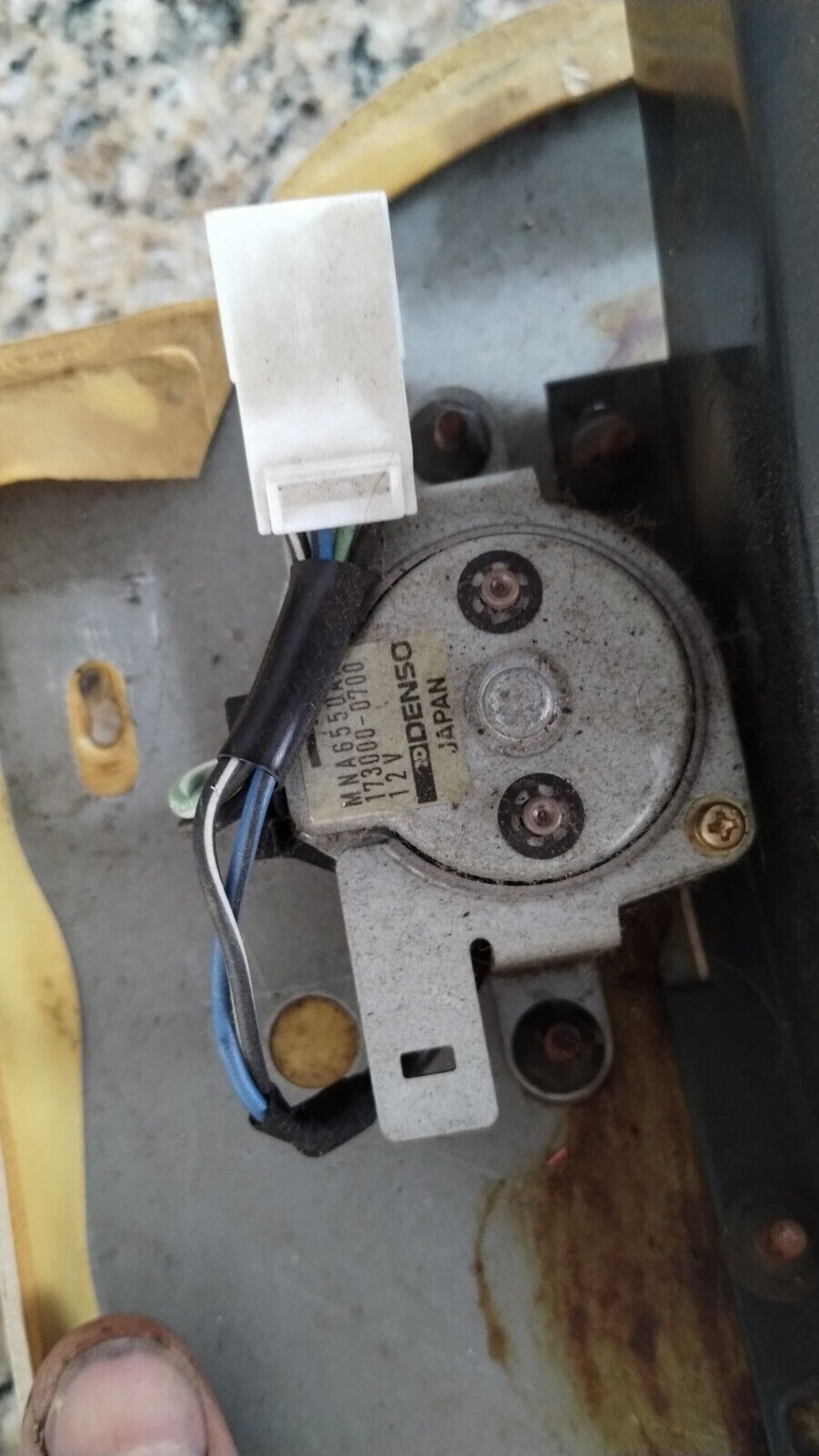

It is a Cabin Temp sensor / fan below the steering wheel column to the car's left
It gets clogged with lint and can only be cleaned with air , least removing the fan oil that lubricates it
The panel below the steering column has to be removed and cleaned from the back side
Pic coming
It gives no code when clogged as the circuit is just fine
It is a thermistor ( solid state device ) sensor and in my all-encompassing theory of Parker if it gets clogged the thermistor being feed energy is not dissipated by moving air and is biased to have a higher temp signal than actual cabin temp hence your A / C being on and heater not
