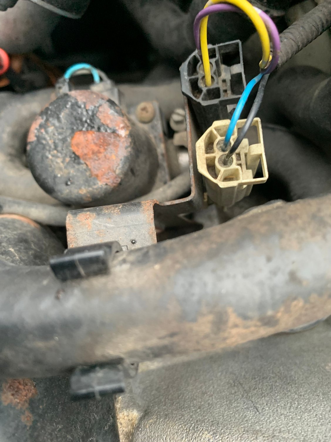

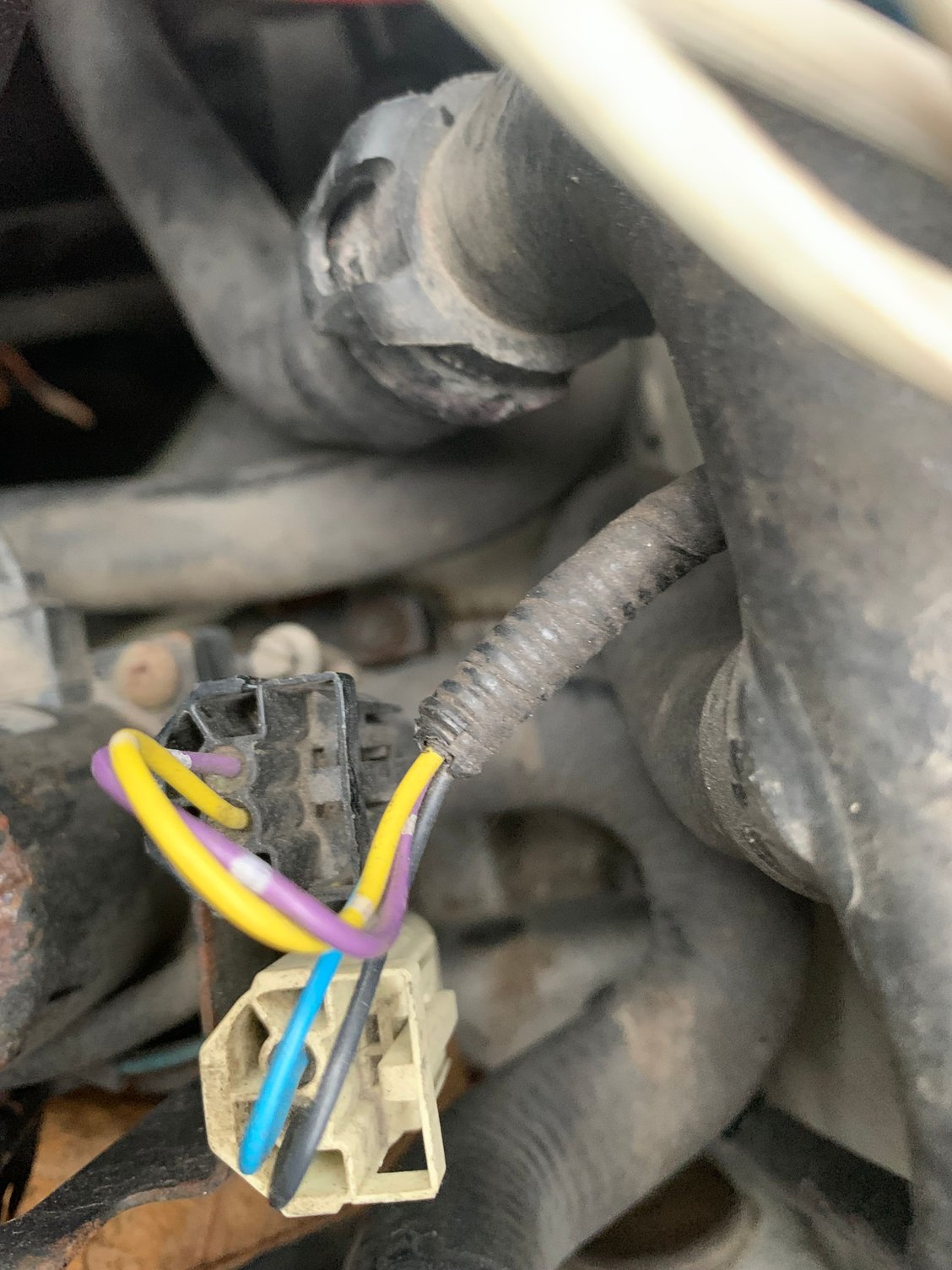

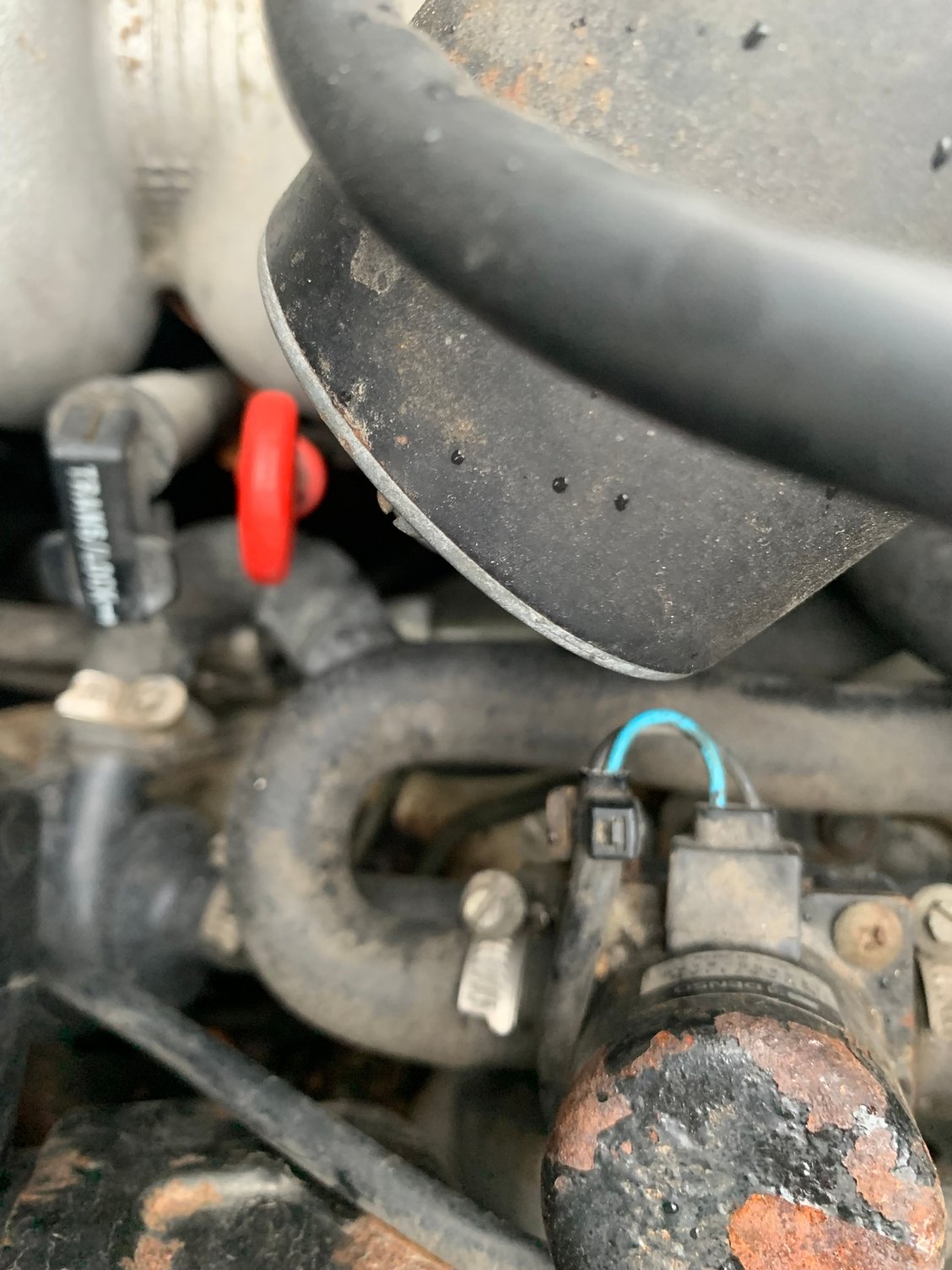

The round cylinder part has two hoses going into it. The top one is hot and the lower one is cold. What should I check next? Are these parts the same on my 95 xjs?

Jaguar AJ6/AJ16 WAXSTATS tend to fail OPEN.
You still need to check the Valve and pump.

You'll need to get replacement carbon brushes for the pump, its 99% down to them, especially since you clearly never replaced them.
All details here:
Jaguar XJ6; Jaguar X300; Heater Pump
Replacement brushes need to be 4mm x 4mm x 7 or 8mm long. You can file down 5mm ones if you wont have access to 4mm ones. Takes a couple of hours to do it first time.

A non running electric pump will still have some flow at higher engine RPMs
The pulleys on the crankshaft harmonic balancer can fail to spin explaining your no coolant flow though the engine block
You can tap on the electric coolant motor with a broom handle to free up what is left of the brushes
There are aged rubber mounts under the electric motor so don't tap too hard
The electric pomp will run at all times in heat mode selection , the solenoid will throttle the coolant flow on and off
The brush # is 33A ( X 2 ) from Eurtonelectric out of California
Double checking that last information
.15" x .15" x .35" BRUSH 33A (eurtonelectric.com)
and
33A Brush - Part Number 49201010 - Bodine Electric (bodine-electric.com)
