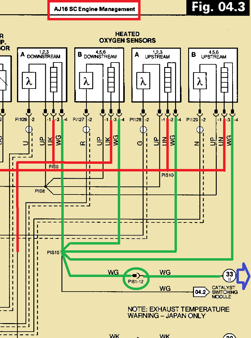

You do have a fuse to look at and this has to do with the O2 sensors that are warmed up by heaters
The fuse # 14 / 10 amp right engine fuse box covers all your O2 sensors , you may have 2 or 4 O2 sensors
