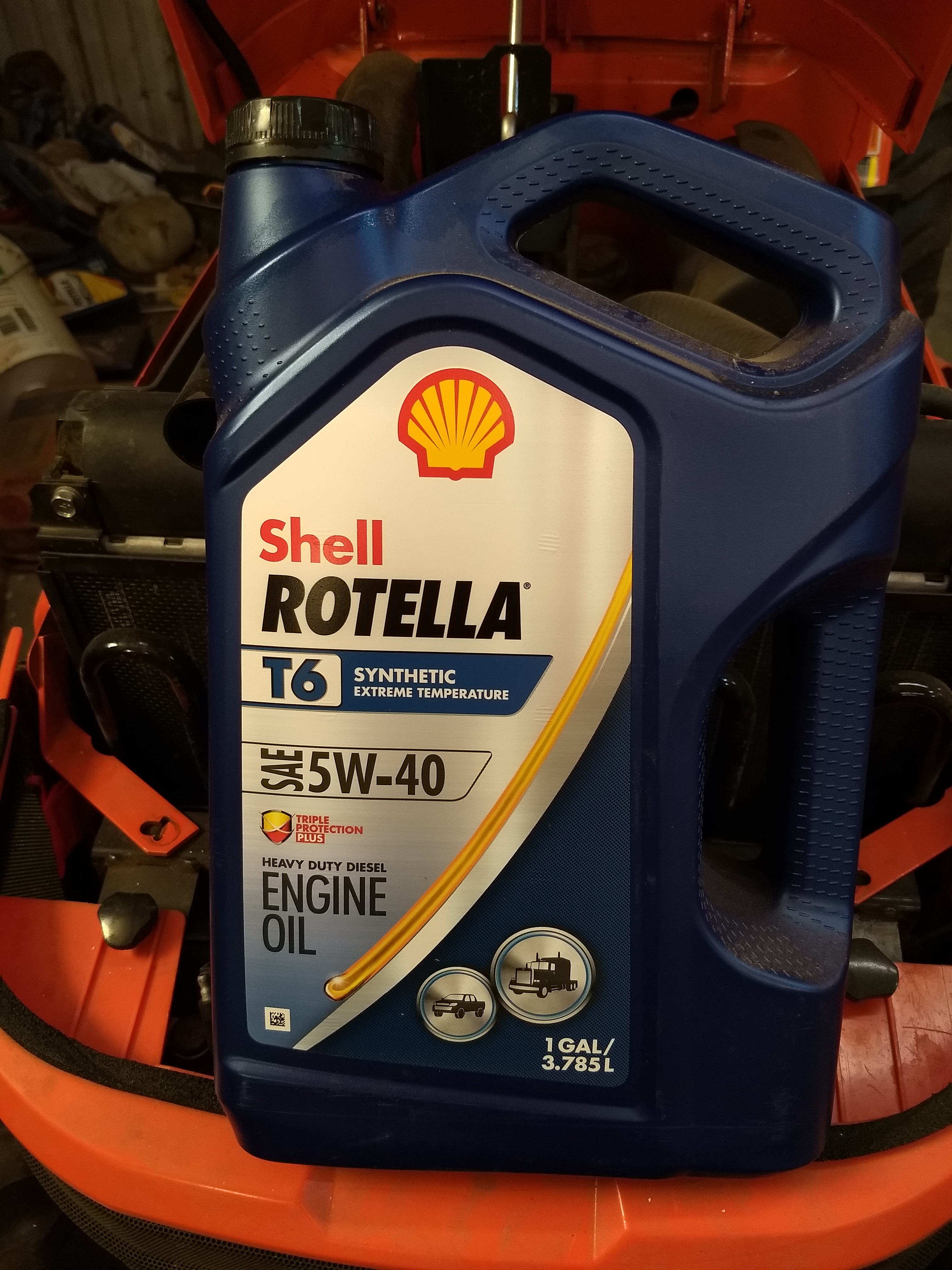

Originally Posted by SleekJag12
5W-40? Did you mean 15W-40?
I see that most 15W40 oils are intended, or at least marketed to be used in diesels, including the Rotella T6. So that oil works well in the AJ16 then, and is "within spec?"
Nope. 15W-40 is what used to be called simply Rotella T - the dino version. I think they have since bestowed a number on it, either T-4 or T-5?
T-6 is their synthetic blend of the the same application and is, indeed 5W-40.
It is marketed as a heavy duty diesel oil, but is actually dual-spec and meets the following:
API CJ-4, CI-4 PLUS, CI-4, CH-4, SM, SL, SH; ACEA E9; Caterpillar
ECF-3, ECF-2; Cummins CES 20081; DDC 93K218; Ford WSS
M2C171-E; JASO DH-2, MA; Mack EO-O Premium Plus; MB Approval
228.31; Volvo VDS-4
according to
https://rotella.shell.com/products/t...6-brochure.pdf
My X300 Vehicle care manual urges me to look for the symbol "API SG/CD" and then says take SH where available.
The bar for 5W-40 in the vehicle care's viscosity chart extends all the way across the temperature range.
As an added bonus, it is the cheapest synthetic I've found, and generally readily available at Walmart. I suppose the massive population of full-size diesel pickups registered here in N. TX probably helps drive that availability. Your mileage may vary.
