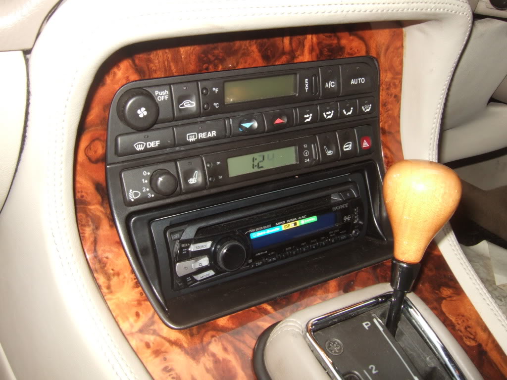

I recently swapped the head unit out.
Got the kit off ebay I think one of the members, Jack, who pointed me in the direction it may of come from dynamicsounds
So much better now
Plus Ive sold the old head unit on fleabay
