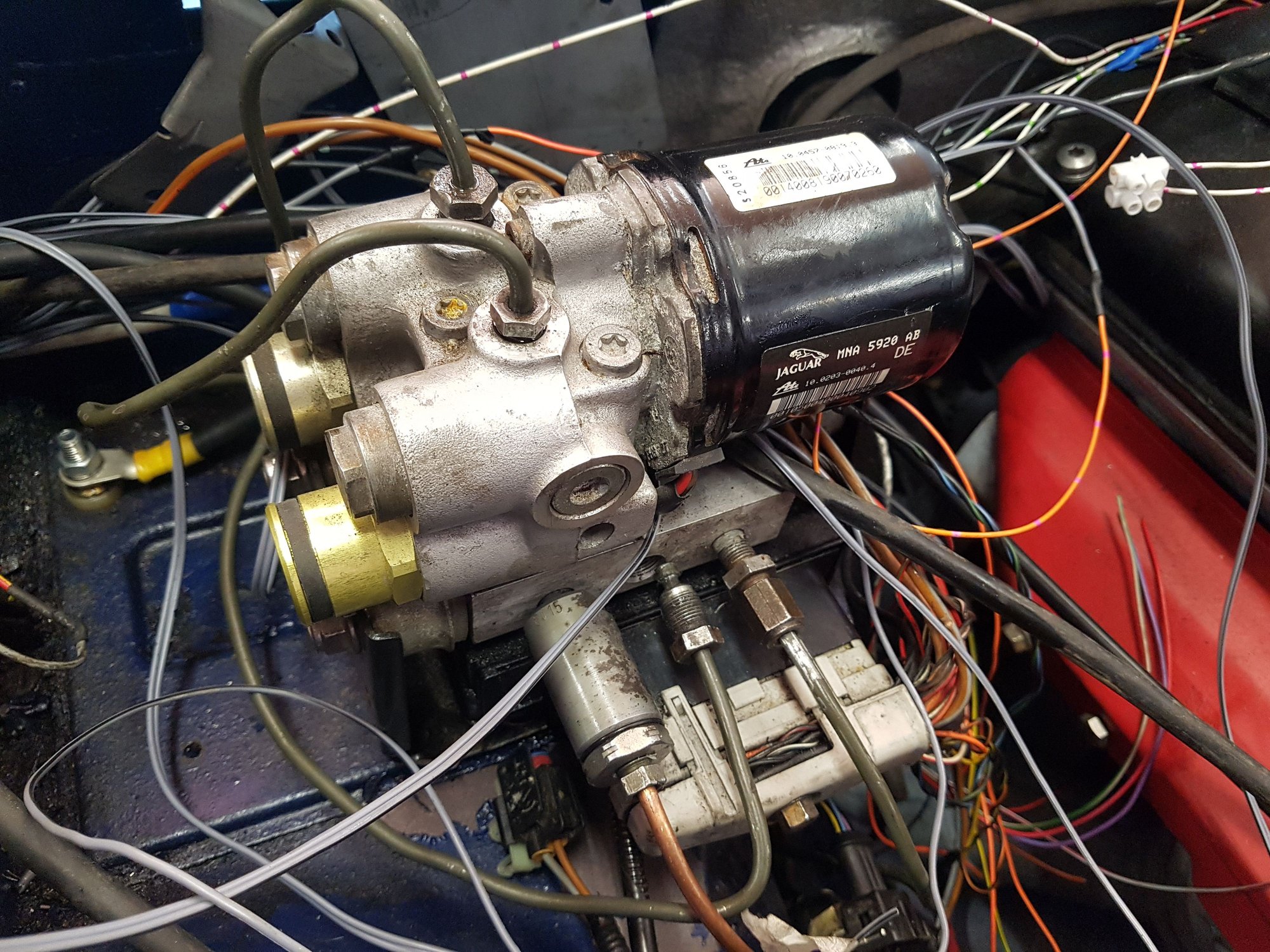

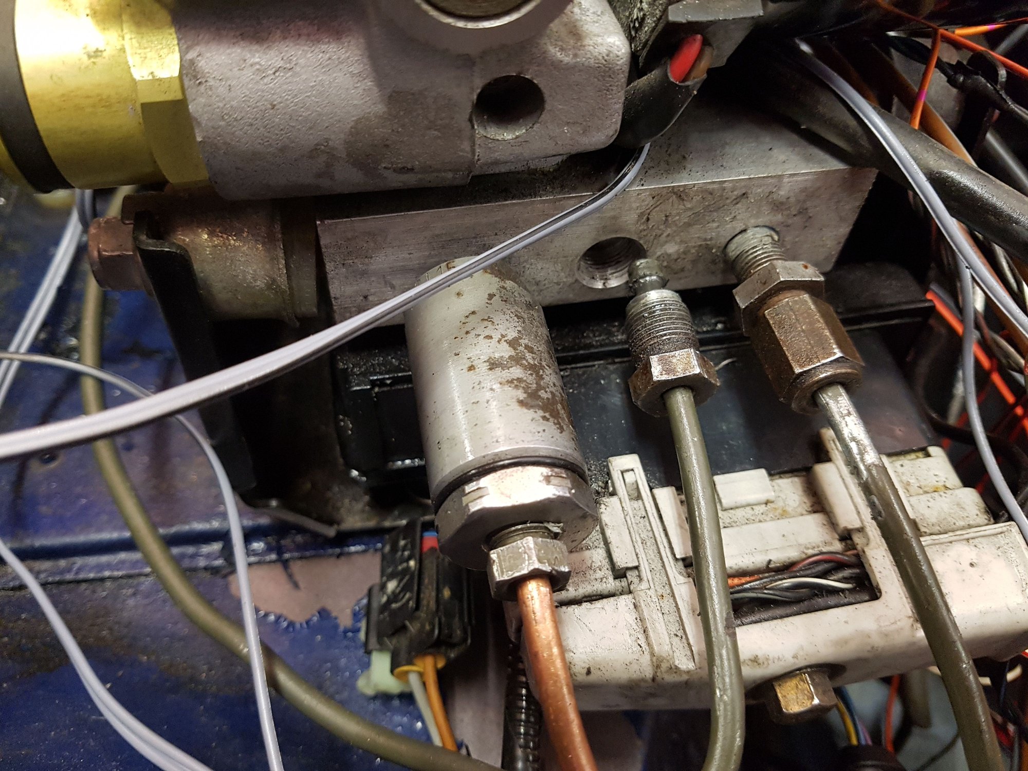

Hello Jaguar-lovers;
After fixing a brake-problem I have to renew the brake fluid on all wheels.
All works fine except for the right front-wheel: it turns out that the brake-fluid does not pass one of the ABS-module outlet-ports: see pictures.
What do you think it can be ? Is it perhaps some dirt in one of the valves?And what do you think, can i try to put somme pressured-air on the outlet port?
Many thanks in advance, greetings, Rudy

X300 ? 1994.5 - 1997
See page 222 and 248 of the very large doc link below
http://www.jaguarclub.sk/service/x300.pdf
and item # 2 below
https://parts.jaguarlandroverclassic.com/parts/index/part/id/C50.C5058.C5058290.C50582905347/brand/jaguar/
Conscious pressure valve

In my opinion are the fluidlines normally open and should all the outletports bleed when then brakepedal is pressed down, i look further, and let you know.
Tanks, Rudy
