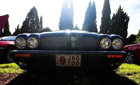

G'day Sark,
My car has the mesh grill even though it is a V12 which should have the vertical bars. The original owner must have specified the mesh.
The mesh is 7mm x 7mm squares and the mesh wire is 1.5mm dia. The mesh support is colour matched to the car , have a look at my pic.
The mesh panels have two small tongues at the bottom which fit into the frame and they are secured by two SS screws at the top.

So, I take it the open area of a square is 7mm...then the hypotenuse is close to 10mm (9.9mm).....plus the wire is 1.5mm...then the pitch from centre to centre of each square is 11.5mm.
Thanks...I'll work on that.
