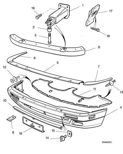

The wings bolt on, and the bumper hangs off two 'towers' which stand forward off the front of the car. The nuts/bolts in the towers are a weird mix of metals (alu and something - I forget) so they will likely have seized. I removed the towers from the car with the bumper attached and then (destructively) removed the towers from the bumper. New towers aren't too pricey. You'll need the bumper off to remove the chrome as it's secured with screws from behind.
JaguarClassicParts.com has an excellent set of diagrams.
Bumper-Front-Without Energy Absorbing Strut - Parts For XJ Series from (V)720125 to (V)812255 (X300) | Jaguar Classic Parts UK

I took my wing off last weekend to replace it an also repair the front of the sill. I was lucky in that I managed to undo the two bolts number 3 above with a long bar they were stiff but nothing broke. The bolts are easily seen under the front of the bumper. Once these ate undone unplug the wiring conector on each side and slide the bumper off forwards, it is not heavy. Remove the wheel arch liner by pulling the centres out of the plastic tags. The wing has two bolts inside on the A pillar and one inside to the sill, the others ate all obvious. Be aware that some may snap due to corrosion, so a drill tap and suitable new bolts are a wise precaution.
