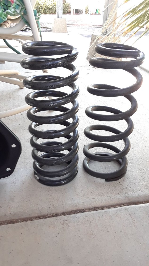

Originally Posted by kylexj6
... has anybody upgraded their rear springs from the early short ones to the longer later ones and if so what was your experience.
I upgraded the rear springs on my car about 2 years ago. 7-turn JLM11422 to 9-turn JLM12257:
Unladen, the new version spring was about 1cm taller than the original, which is what translated to the rear ride height. This year I added a second 6mm disc shim to the top of the rear springs to get a little more boost, and am happy with it.
If you think you will tow a caravan, the better springs would be a very good idea. New KYB springs would probably be the best, as Katar says. I am now using KYB shocks (new with the upgraded used springs) and I like them. Supposedly comparable to the Bilstein B6. Got a firm rear end now, to match the front!
Best to plan on doing both sides equally, especially if you want to change to different rate springs or shocks.
If you search used springs, you can use the JLM12257 or the JLM12342 (sport/supercharged, more firm). Both were also used on certain versions of the XJ8 and XK8 and will fit the X300.
