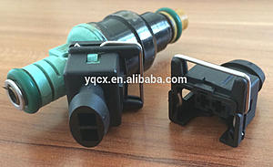

Hi, does anybody know the part numbers for the marker light plug and wiring harness? Or where to get them? Are they off the shelf at the parts store?

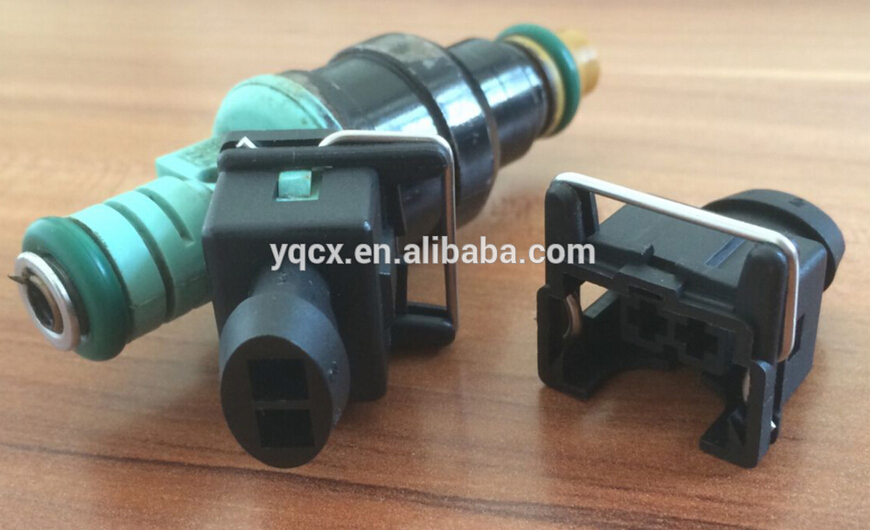

Do they look like this ?
I looked at mine and they are available at the auto parts store as a EV1 connector same ones used all over the engine and truck dome lights that can be borrowed . Aside from that connector the 90 degree base looses contact with the bulb and the bulbs wire loops can be bent out to make better contact . Also the square connector a foot or so inward from the connector in the pic gets corroded .
