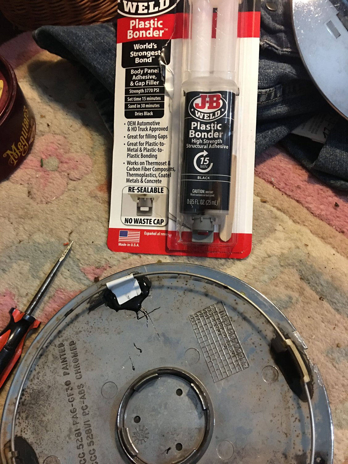

I used this stuff to repair the black plastic, front inner wheel wheel covers on my ‘87 BMW. Hope it works on this.

We'll be anxious to hear how your repair holds up. I think you chose a good product for the repair. The Plastic Bonder is definitely better at adhering to plastic parts than the regular Cold Weld product. Permatex also makes an excellent Plastic Welder in black and cream colors:
