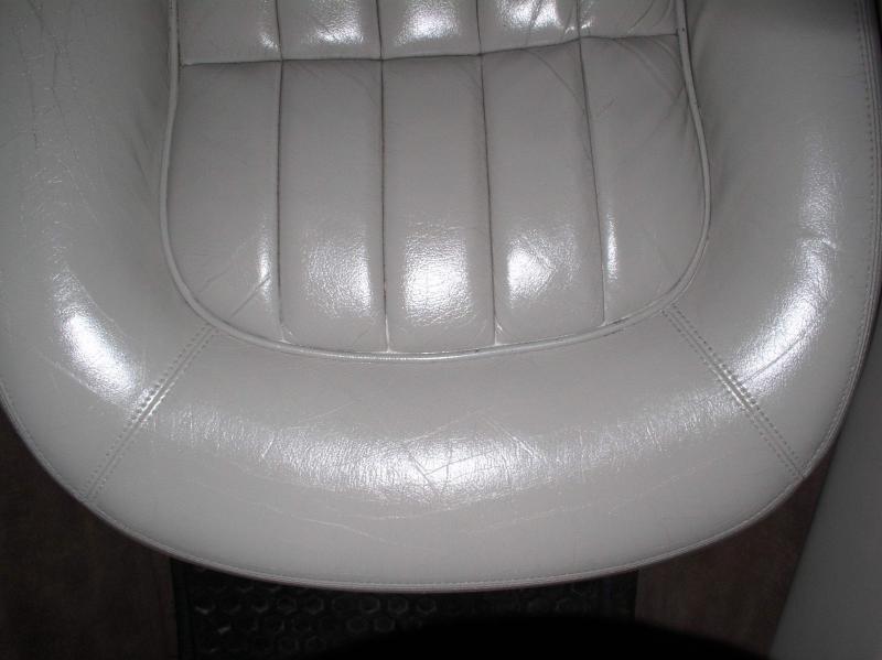

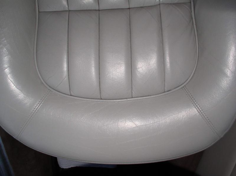

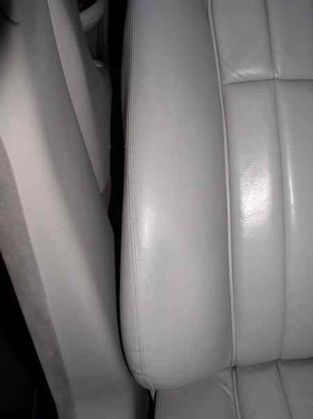

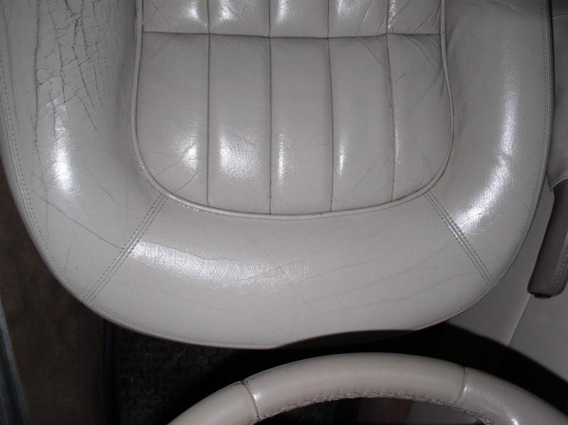

As Doug says, there's many products available. I used Gliptone on a badly cracked driver's seat in my XJ8L. Here's the results:
1. original cracked seat base
2. after cleaning
3. filled and dyed
4. clearcoat applied
The only thing I didn't like was the shiny finish compared with the original matt finish. The seat back had the typical scuffs on the bolster. This didn't need any filling.
5. scuffed driver's seat bolster (RHD)
6. after cleaning, dyeing and clearcoat
I'm sure other products will be as good and some may be better. I kept the vehicle for twelve months and 12K miles after this treatment and the seat was just as good when it came to be sold.

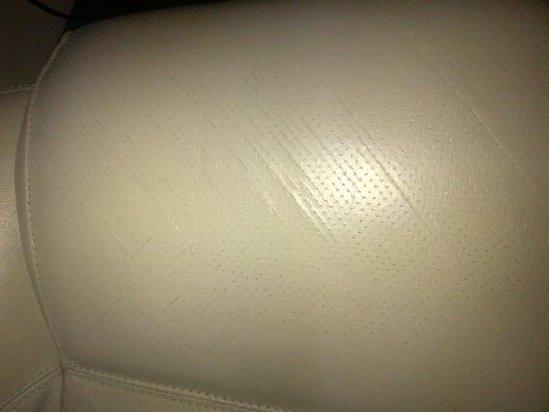

Hi guys, I've used "Magic Mender" to restore my drivers seat with good results and the OATMEAL colour match is excellent. I only had to "blend" in a few inches around the repair area and it's almost impossible to tell where the new colour starts and finishes. When ordering on their website you can nominate make, model & VIN and in the Jag section it lists the OEM colours by name and code.
Anyone with an X300 Sport model that has the perforated leather seats (mine's a '97) will know that splits develop between the perforations especially on the drivers seat front cushion. Mine had this problem, spoiling an otherwise unmarked interior. I bought the kit that includes a cold compound filler, it's easy enough to use and the results are OK (though not perfect) if you follow the directions to the letter. I did the job 6 months ago and it's been durable enough with no splits reforming. I even painstakingly pricked the repaired section to create "new" perforations that line up with the rest of the seat, although I expect this will weaken the repair. For $60 it's a lot better than putting up with the splits (mine were pretty bad), and a whole lot better than forking out the $900 I was quoted to recover the seat with new leather (although admittedly that's for using the Jag original). I still have plenty left in the kit to do more repairs if ever needed.
Unfortunately I didn't take a "before" photo, but here you can see the "after" effect of using compound and colour.
If you don't need the compound you can order just the colour kit for around $25
Link: Leather Repair Kits - Do it yourself leather repair products for furniture auto just about anything leather or vinyl
Cheers,
Tony.
