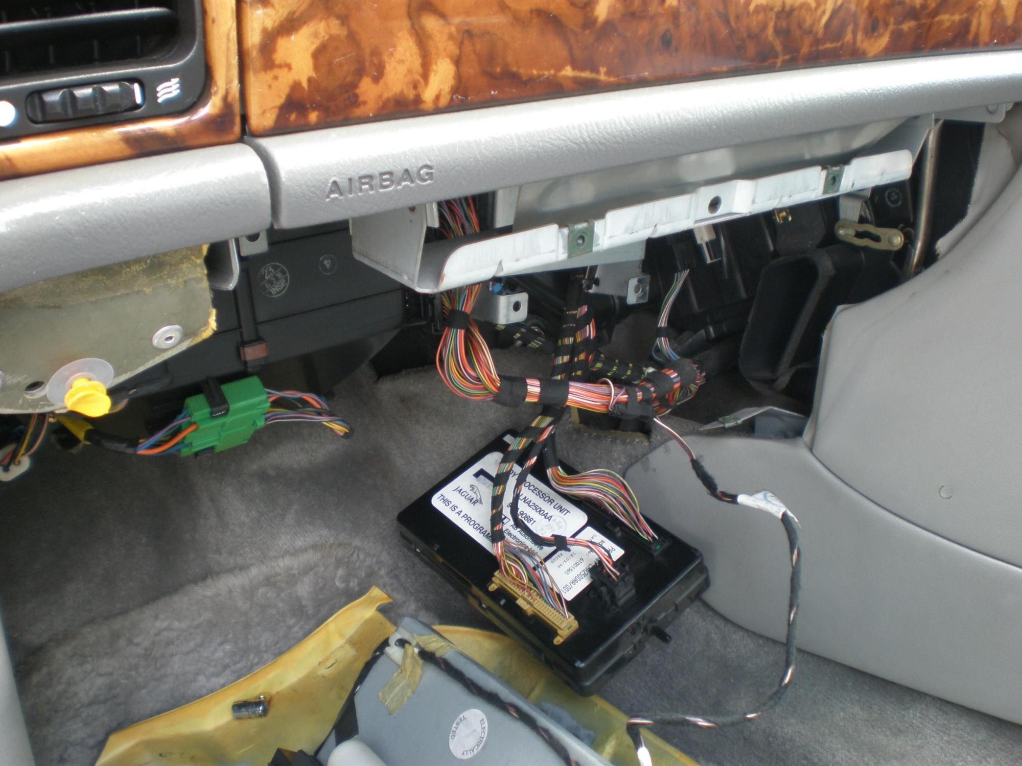

Next is to check the Body process module connections , which i think is located under the glove box.

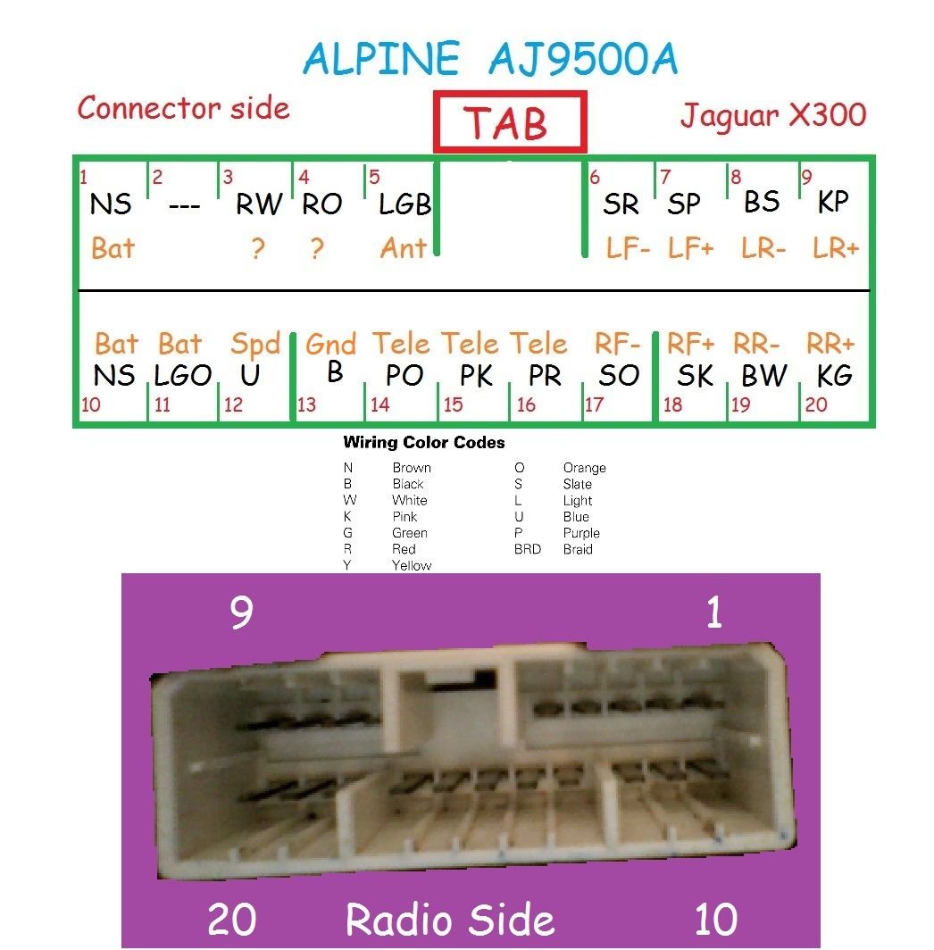

The # 8 fuse is ok for the arial. I took it apart, and the motor works. The arial goes up and down by applying 12 volts to red and black motor wires.

To get the arial to move it receives a low current ground by the stereo head at pin 5
