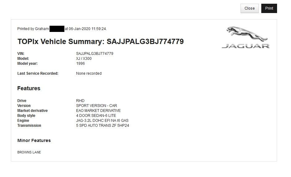

VIN doesn't give this level of detail and only the basic X300 data is available on Jaguar TOPIx. Here's an example for the 1996 XJ I had:
Later models detail everything (including headlining colour) under Minor Features. The older model data is still on the previous system. A Jaguar Dealer could look it up for you on the old Direct Dealer Warranty system.
