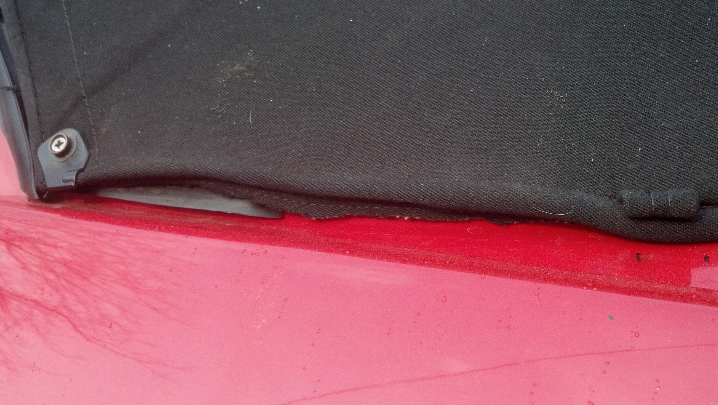

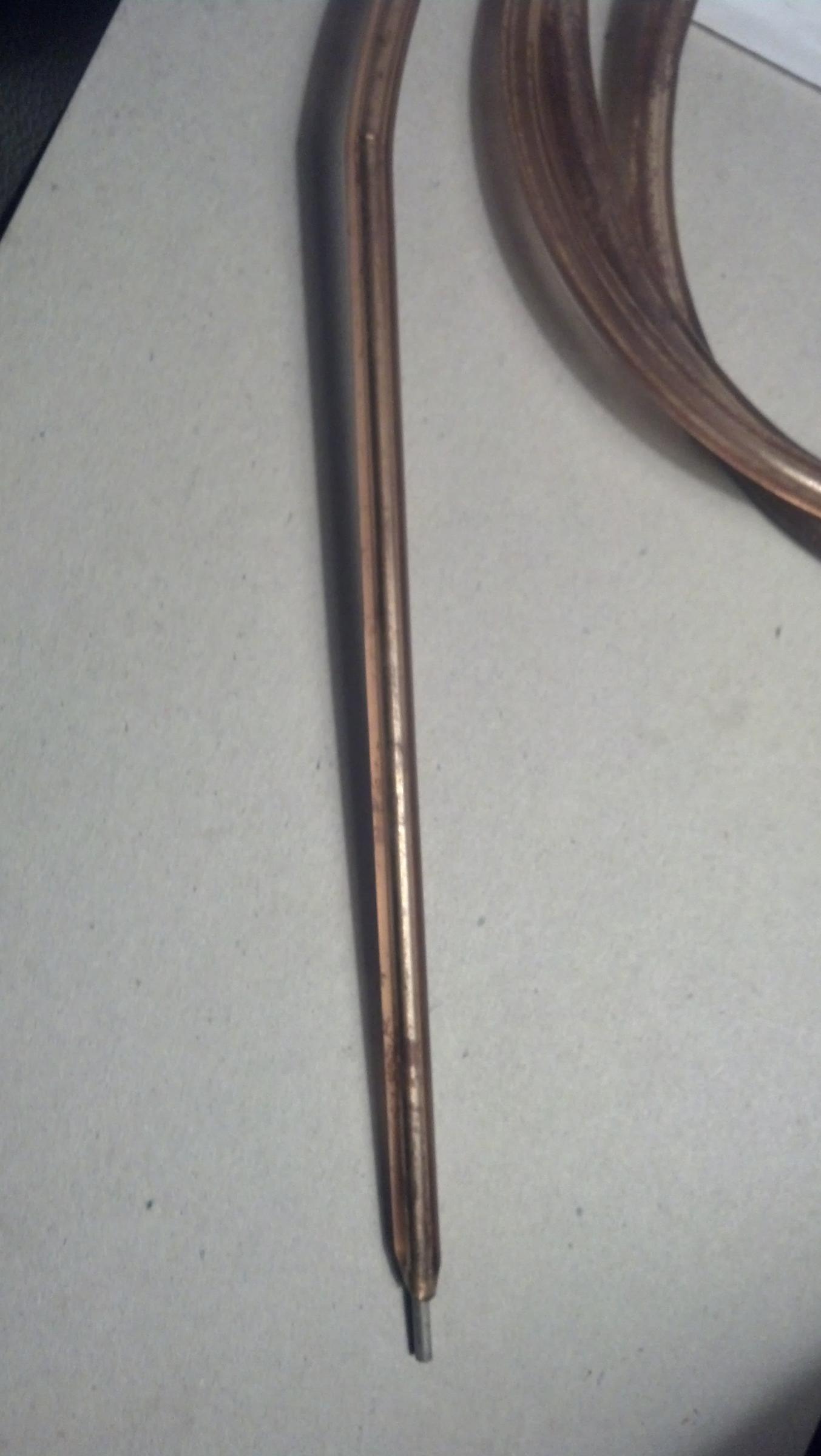

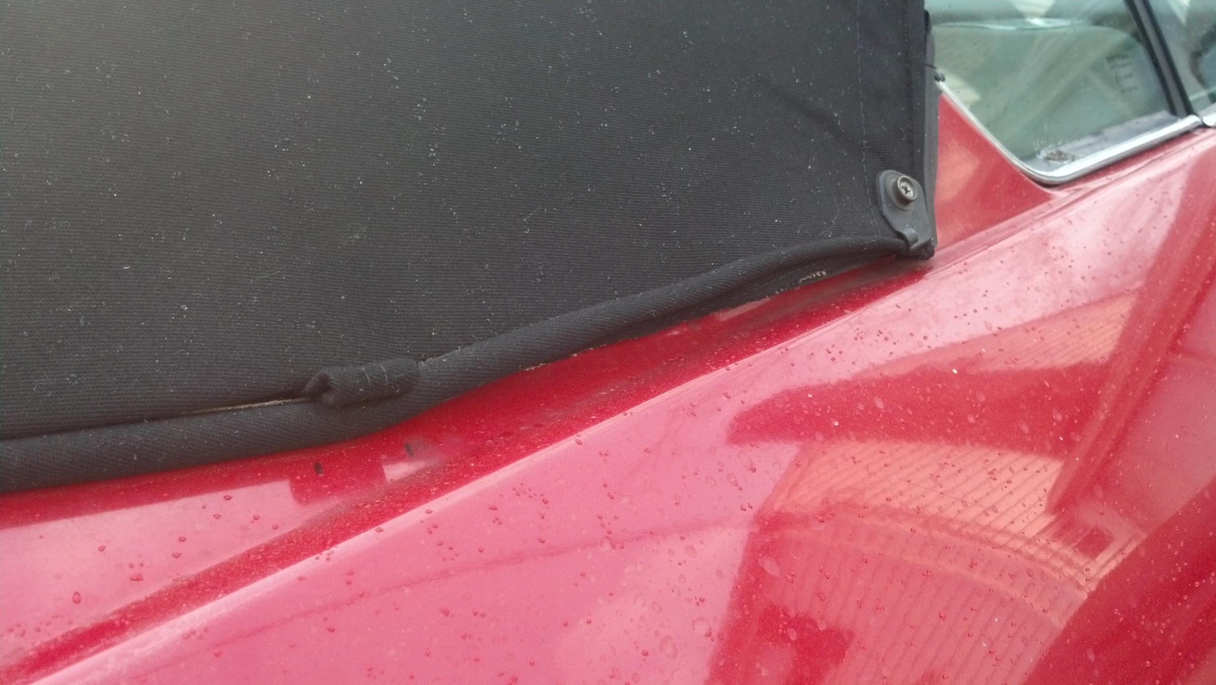

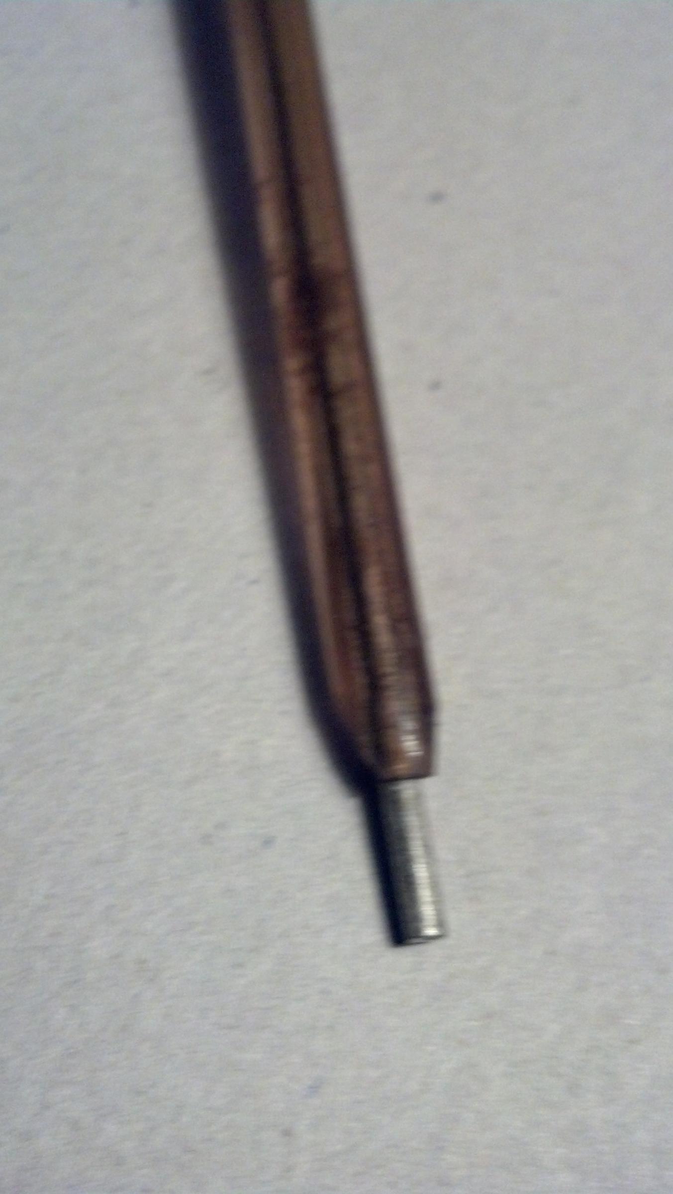

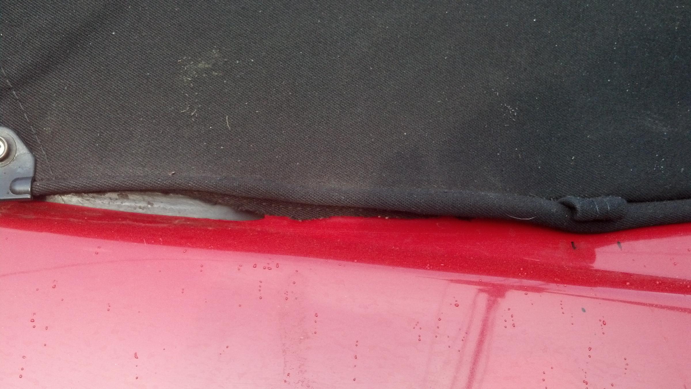

Your new top is lacking a part that the oem Jaguar direct exact part would have and it makes a BIG difference with the new install. The very bottom at the rear of the top where it is fastened to the body by a cable there is a sewn in tubing (actual vinyl in the original). It acts as a border after completion. In the original jaguar top there is a metal rod at the 2 ends where the rear bottom of the top ends at the quarter window. There are plastic pieces that cover the ends that are screwed in with snaps for the top cover. These metal rods are approximately 6-8 in. long and span the last distance to the 2 ends and there is a good reason the original top has the metal rods. If they're not there the material will tend to pull up as it is stretched onto the top upon installation,and this does not look good on completion. I found this out by doing the job myself but, I didn't have the ability to sew in the metal rod. If you are taking your top to an UPHOLSTERER then they may be able to put your original rods (you must cut them out of the tubing) into your new top. If your upholsterer Knows about this and knows a way around it then good. In order for your new top to look right it must stretch slightly upon closing to look smooth and this area is pulled upon greatly thus why the jaguar people put the rods in, but the repros eliminated it. Maybe the pros have sorted this out but you should at least inquire about this aspect to make sure your top is PERFECT. Tryin to help BUD

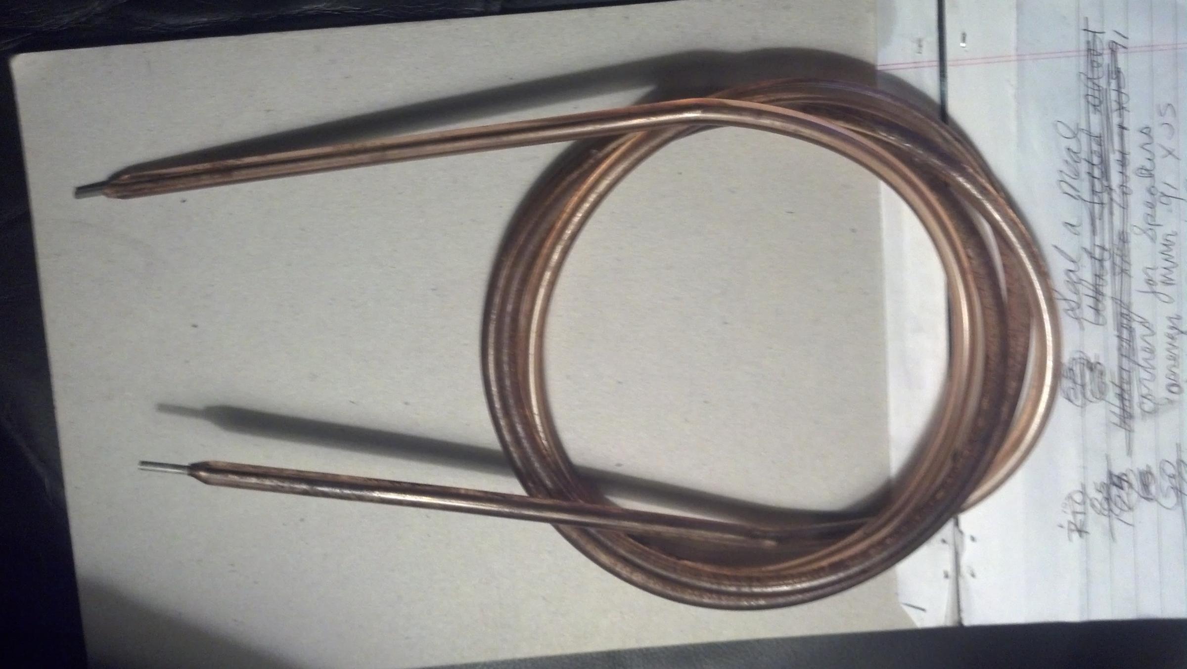

You'll see what happens not having that rod in there. I suspect that your upholsterer can split the threads and insert it and sew it back up? It really needs it. Bud

I've copied your note and sent it to them...since I'm paying for the job, if it's not right, I won't accept it :-). Thanks!
