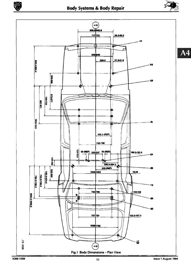

It must have been some impact when the other vehicle is totalled. I'd be doing a careful appraisal for distortion before thowing money at parts - especially the rear longitudinals.
The Workshop Manual has body dimension drawings to check for accient damage.
Apparently "cosmetic" or superficial panel damage can turn out to more serious.

Thanks for the reply. The car need to go to the collision shop for an estimate and they (and I) will look at the chassis to see if there is any damage or the parts can just go right on.

Just a couple of additional things to consider: There is no traditional chassis in an X300. The body, floor pan and rigid reinforcements are all welded or otherwise bonded together to form a monocoque, or what American makers call a unibody. The independent rear suspension bolts directly to the monocoque. The rear quarterpanels and trunk floorpan are part of the monocoque, so any deformation will be difficult or impossible to repair.
Another thing to consider is that in a violent rear end collision, the inertia of the engine and transmission resist forward motion to a greater degree than the body, so while the body lurches forward, the engine/trans momentarily remain where they are. This can damage engine mounts, front subframe bushings, the transmission mount, and even things like transmission cooler pipes, fuel pipes, etc., so make sure all of that is inspected as well.
