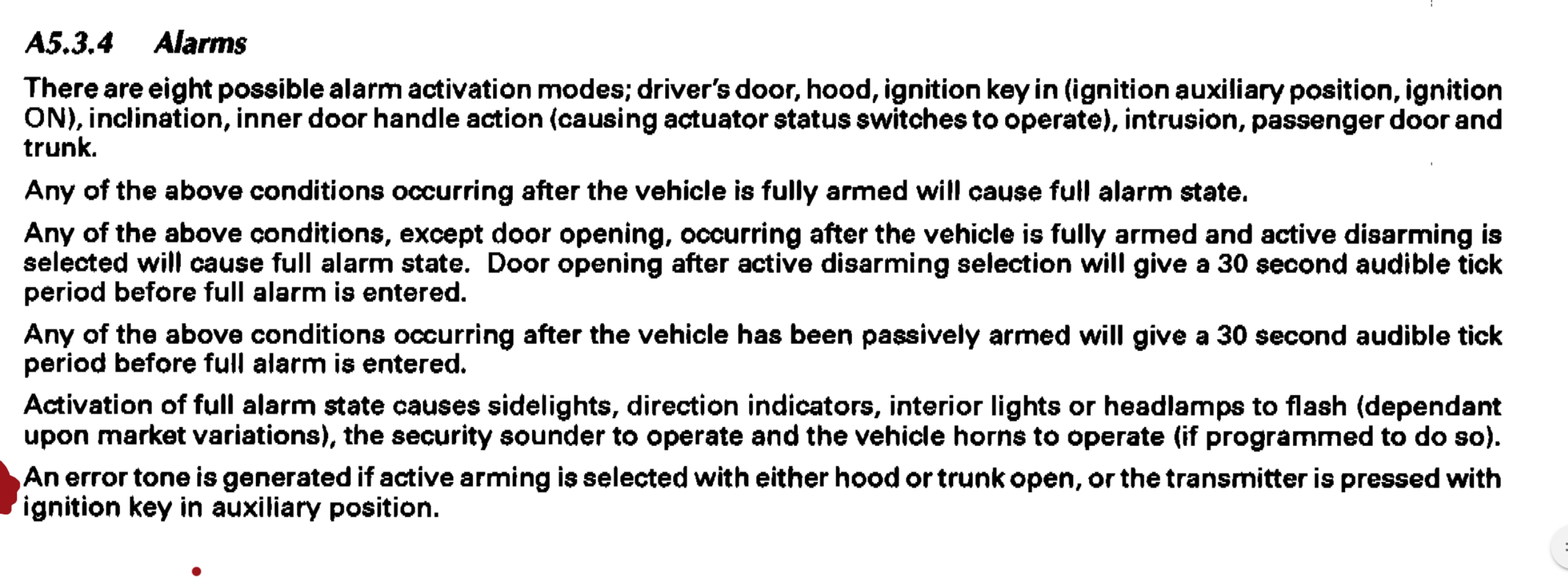

Update, so I started to do a reset on my car and opened the trunk. However, I decided to fallow the security troubleshooting guide and it said to put the key in and turn the ignition and then open all the doors to see if the dash light comes on. So I opened the drivers' door and the light came on and I closed the door. Then I looked back and noticed the trunk was still open. SHould there be a light on the dash if I open the trunk? Since there was not one I assume that the trunk microswitch is hosed? I can't see where that is located. Can someone help me with that?
After doing the reset here is where I am
1. Open the trunk and turn on the key.....no light on the dash
2. Press the remote to lock and arm....Everything locks, get the two beeps and then the error beep.
3. Press the remote to unlock one disarms, driver door unlocks, press twice all doors unlock and press the third time trunk unlocks.
If I try to lock the car with the trunk open then I get the beep right away and the same thing with any door. So the reason the light does not come on could be a bulb. So DOn't think it is the trunk. Has to do with possibly the issue that I am having with the right blinker

Took the car for a drive and when I stopped to eat went to lock the car and right off the bat got the error tone. So I think that it thinks that something is open. I assume it is the trunk. When I get home I will look at the switch. Is that switch normally open or close? I would like to test it and see if it is the switch. Also, I went to check the hood switch. Well, I found the connector just above the siren, but it had one of those temp plugs on it.
