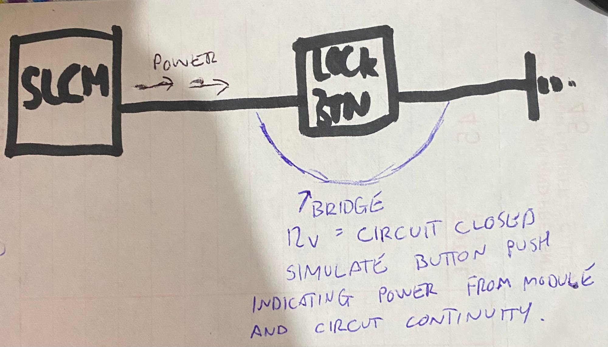

This is a depiction of my thoughts.
happy to hear where i am misguided as i am confused and love to learn.
i thought power for the switch was from the module.
but that makes no sense as if power came from the module then you could not test the pin 19 unless the module was plugged in, and in doing so grounding that pin out would close the circuit regardless of button push and you would not see and open circuit at all.
do i test pin 19 with the module plugged in or unplugged?
i thought i had a good understanding of electrics but this car with its modules and its negative triggers is showing i know nowhere near what i thought i did.
great for learning though. thats for sure

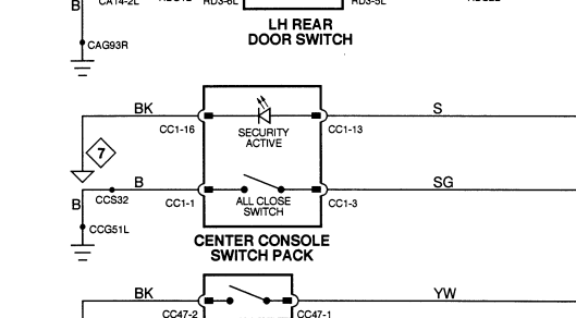

here is an example of the kind of thing that is confusing me.
when you look at the central lock wiring diagram it shows SG going direct to SLCM
but when you look at sliding roof controls you see it also runs to there.
is there a way to find out where splice points like CAS16 are?
to be able to work out where all wires run to?

Originally Posted by Spud Maat
excuse me if i am wrong, but seeing voltage implies continuity. correct?
so if bypassing the switch and bridging the connection near the switch is showing voltage, this shows continuity in the circuit from the module to the ground?
and therefore should act as pressing the button?
because from what the wiring diagram tells me the power comes from the security module and earths out when the switch is pressed.
Ah, yes that’s correct…and it should operate your locks when you bridge it
so if they aren’t working, there must be a problem somewhere else 🤔
They leave out a lot of steps in their procedure but essentially they expect you to disconnect the battery and the security module and then check for continuity from the 22 plug to the switch
Old Oct 12, 2022 | 02:55 PM
someguywithajag's Avatar
Joined: May 2015
Posts: 601
Likes: 93
From: Canada
unfortunately I’ve never been able to locate splices …I try to break down the harness into sections at the plug level and usually can find the issue from that
sometimes I do find damaged individual wires btw plugs by visual inspection but that’s the best I’ve been able to do…
