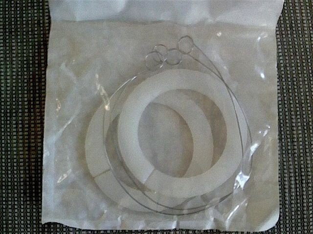

If you look down from the top with a light source on the bottom you may see a gap where these white colored shims tighten up from the original installation gap
This would be between the black frame mounting and the gray colored steering rack or I can be wrong on that
They can be installed without removing the rack
Jaguar part SPC1059

The fix he mentions is of course legitimate, I myself have a set of the proper plastic/nylon shims previously mentioned, however have had no reason to actually fit them.
